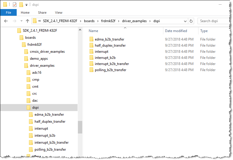

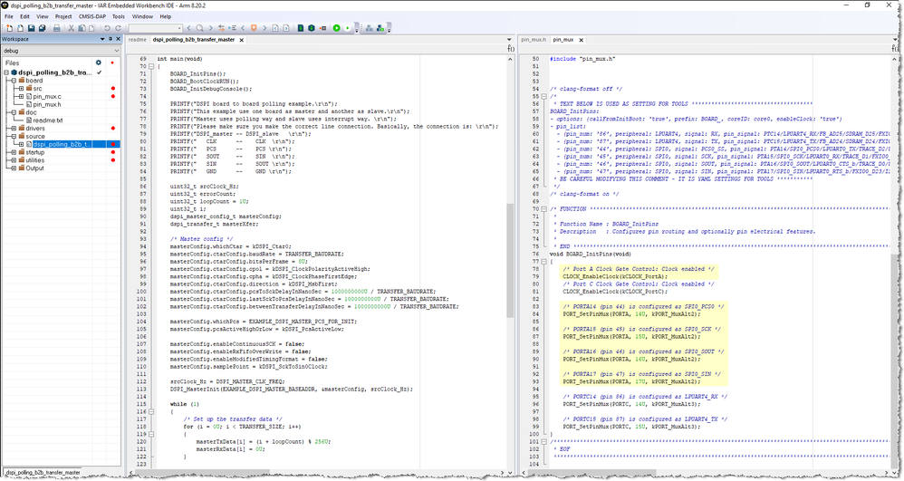

Hi Gokulnath Kasinathan,
Seems that you have download the MCUXpresso SDK. Why not direct refer the dpsi examples in it's folder?
For example: You can modify the SPI0 pins in BOARD_InitPins function of dspi_polling_b2b_transfer_master example. Check if these pins are able to output waveform.
