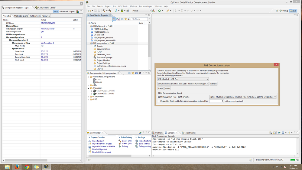

I am trying to program K20 custom board but it is showing an error.
after clicking yes,  the same msg appear and again I click yes then following error comes
these two error msg comes after one another and it doesn't program. Kindly look into the matter initially I had the same issue for K10 board. I tried everything but It didn't worked. PE multilink universal not detecting K10 uc I thought that there might be some soldering issue as it was a QFN package. so I changed my design and added MK20DX128VLF5(LQFP) we bought 100 pcs of this uc and 100 pc of KL05 , 30 pc of K10. we checked for K10 and K20 uc it doesn't work. I checked PE multilink by programming FRDM-KL46Z board through SWD connecter J6, it is programming the board without any issue. I went through the KQRUG user guide which I found out from my previous query regarding K10 board through the community. and I also went through the PE4576-Technical summary. and tried resolving the issue but didn't resolve then after bashing my head I somehow managed to find an app note on programming kinetis uc i.e AN4835 which I think is supposed to be mention in the datasheet as no user will get to know that there exist an app note for how to program the Kinetis uc. There are many engineers who will be working on ARM cortex uc but if there is not much resources then why will they choose freescale. Kindly look into the matter and make the programmer work as I fear all the above controller i.e (100 K20, 100 Kl05, 30 K10) uc will be collecting dust. Already we have 100 k20 boards ready. The following diagram shows the connections I have tried for different modes(JTAG/SWD) for programming K20 board.

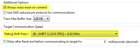

5) This should not be critical, but try replacing that 1K resistor with one of 4.7K - 10K. Also confirm that you have the R2 10K pull - up resistor connected to pin 21, and measure voltage in that pin to verify that it is always in high level.
Now, the 1.64 V is definitely not correct, the value should be near the 3.3 V when not asserted. This seems to indicate that the MCU is constantly resetting. You need to watch that pin with an oscilloscope.
If the device is resetting, this may solve the issue:
- Make sure to select "Always mass erase on connect", and select a not so high debug frequency (e.g. 0.10 MHz).
Then follow the next steps:
1) Disconnect the board from your 3.3 V source.
2) With a jumper force the reset pin to a low level (GND) and hold it.
3) Power on the board (connect the 3.3 V source). Do not release reset yet.
4) Start a debug session and as soon as it is starting release the reset button.
Try this more than once.
Additionally, you could also try mass erasing the K20 device from the Flash programmer. Just open the programmer, select proper connection and specific flash configuration file and then click on "Erase Whole Device".
If the Erase is successful, then you should be able to debug.

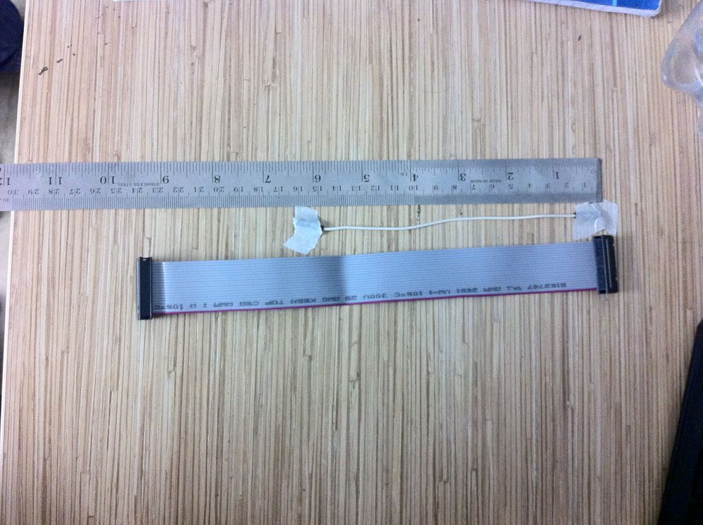

Also, I received feedback from a colleague that 15 cm jumpers are still long in some cases. Could you try with even shorter cables?
It would be great if you can post here a picture showing your connections all the way from the header in your multilink to the pins in your custom board.

I Tried the steps you mentioned (including removing the capacitor) even holding the reset pin to gnd and after clicking mass erase releasing it. but still the error persists....below is the screenshot if you can see the console window in it.
for the jumper length of jumper
I tried for kl05 it worked i.e it got mass erased and now programs are being dumped in it without any error. But for k20 it is still showing the same error... in KL05 there is only SWD but in k20 there is JTAG, EZPort, SWD. Is there anything else I need to do if I am focusing for SWD in k20 apart from the above schematic? as SWD worked for KL05 using the PE multilink universal(PORT B).

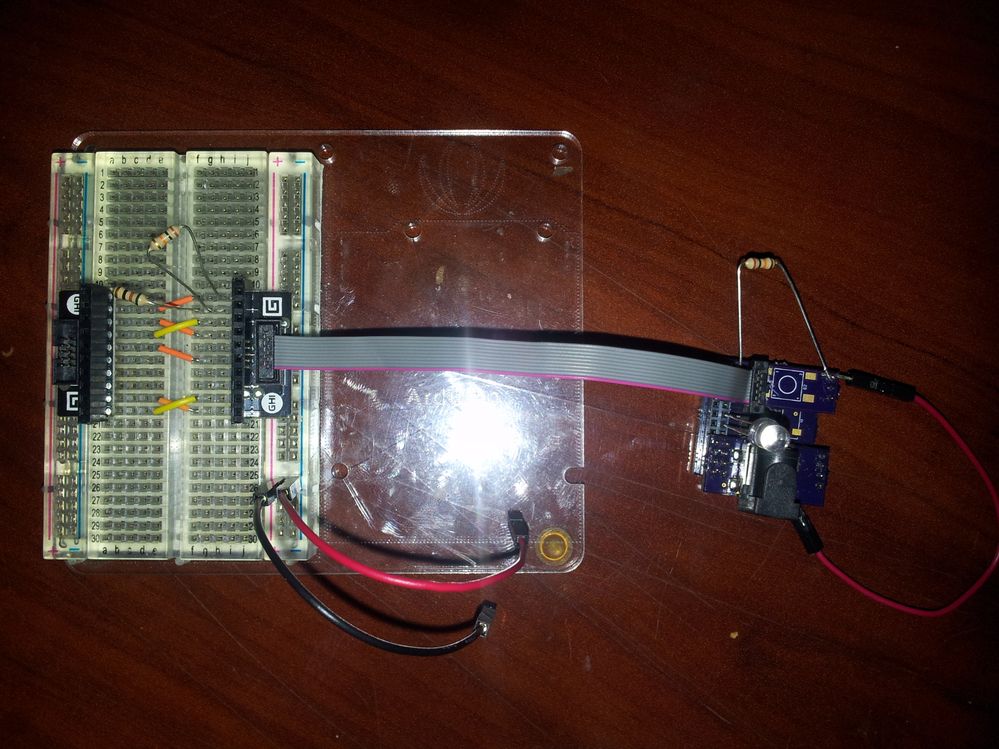

kerbal
HOORAYY!!! I just got my custom K10 board working after reading the above!
  • The board I got working is shown on the right. I mounted only the K10, a 3.3V regulator, one bulk 10uF on the regulator output, and one SMD 10k pull-up on reset.
  • There is a debug adapter board covering the top half of my mainboard; it has only the Cortex Mini-10 pin header and one 1uF capacitor on reset mounted.
  • There is another board covering the bottom half of my mainboard; it has only a DC barrel jack on it, connected to the regulator input.
  • I removed the 1uF from reset while following along through the steps above, but I'm not 100% sure that was necessary.
  • A 10k PTH resistor is attached to the debug adapter between 3.3V and EZP_CS. I'll put this on the mainboard's next revision.
  • The 10k resistor on the breadboard (upper) is connected to 3.3V and SWDIO.
  • The <100ohm resistor on the left is connected to VTREF and 3.3V. It was recommended in something I read trying to fix my problem, but is unnecessary; jumper wire is fine.
  • The connector on the far left is for the Mini-10 cable that came with the Multilink which is about a mile long (~12" actually).
  • The left-most Mini10 adapter is the only one with pin numbers matching the Cortex spec/cable; the two identical adapters I used reversed the pin order, while a mistake on the debug adapter swapped every two pins. With the corrections I'm making, the standard cable should hook directly up and work.
My chip was rebooting like yours, but by the time I had fixed my mistakes, I no longer needed to do the reset trick described; it mass erased on the first try and then programmed on the first try. I suspect I could have skipped the mass erase. So, I put a PWM LDD in my project, deployed, and stuck a UV LED into the socket and HELLOOOOOO BLINKY!!!! (Thanks Jorge! and good luck Amit!)

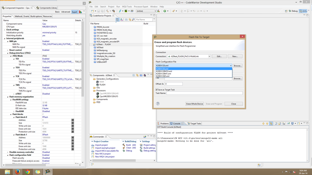

I Have replaced the 1k with 4.7K at reset circuit and have also connected the 10k pullup at pin no 21. before trying with the new uc I wanted to ask you one thing ,in the following image there is an option for JTAG and cJTAG /SWD I tried both but it didnt worked.. which one is recommended?
and also while flash programming there is an option to choose the configuration file, which one is recommended ? I tried with the default configuration file then later I tried with all available configuration file for K20DX128.

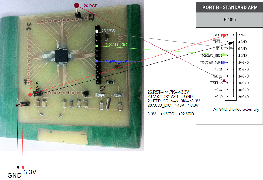

Hello Amit, about your questions:
- The default mode in Kinetis K is JTAG, so I'd go for that. This setting is not relevant right now, as you need to be able to mass erase your K20 first from the flash programmer.
- If your MCUs have a 'Z' in the name (on the top of the chip), then select K20DX128Z.xml, otherwise select the K20DX128.
If you could share with me a picture of your connections from the Multilink to the board that would be helpful.

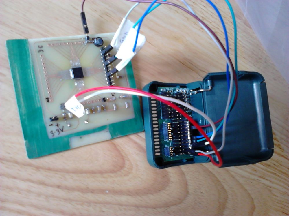

Amit_Kumar1
Senior Contributor II
HI Jorge
Below is the picture of my connections of PE multilink universal with my test board.
I think it will be tuff for you to see the connections so I have made the connection diagram below
Hope the image is clear .
