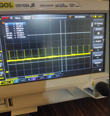

Here is my reset's signal captured on the oscilloscope :

Hi amerzater,
See discussion in "MK60DX256VLL10" RESET PIN.
According to the waveform of RESET_b, it seems that the capacitor is connected, you can first remove it and try to use Kinetis_Recovery_Utility.

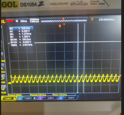

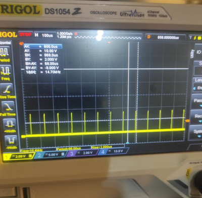

actually , after I have removed the capacitor at my reset pin ( I have kept a pull-up resistor of 5.6Kohm at the reset pin ) I got the next signal at reset pin when there was no PE micro probe connected to my PCB:
and when just afet connecting the pe micro probe I got the next signal : pulses over 3.3V DC line (pretty weird signal ,, that I didn't get it):
I tried PE micro kinetis recovery tool with cycling power -on so many times but unfortunately the mcu couldn't be halted by the tool.

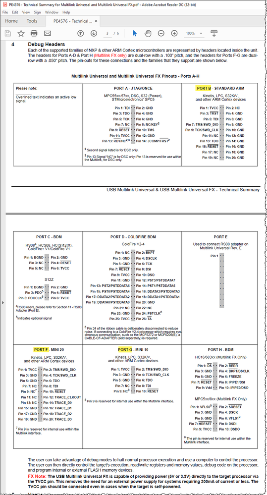

Robin_Shen
The voltage waveform after the PEMicro probe is connected is very strange, please check which PORT of USB Multilink you are using.(PORT B or F or G?)
Please make sure that the PEMicro probe matches the debug interface of your board.
