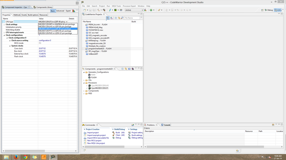

it didn't worked then i tried SWD config

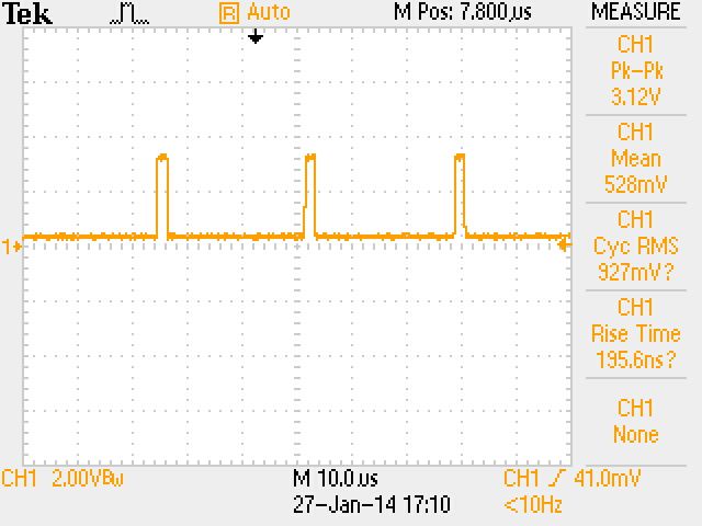

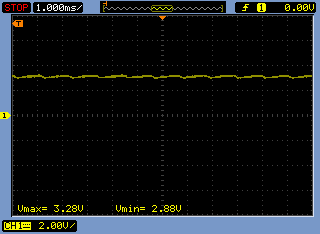

I probed RESET_b pin in normal condition it is logic high(3.3V) and while programming it becomes logic low(0V).

5) This should not be critical, but try replacing that 1K resistor with one of 4.7K - 10K. Also confirm that you have the R2 10K pull - up resistor connected to pin 21, and measure voltage in that pin to verify that it is always in high level.
Now, the 1.64 V is definitely not correct, the value should be near the 3.3 V when not asserted. This seems to indicate that the MCU is constantly resetting. You need to watch that pin with an oscilloscope.

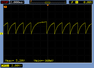

     Thank you for your instant replies. EZP_CS_b pin has been pulled high. I have attached reset waveform captured before and after disconnection. What do they imply?

Can you share the schematic of the reset circuitry? If you are using a cap connected to reset pin please remove it. For flashing the uc u need to remove the cap. but let the 10K pullup be connected to the reset pin. after doing that repeat the steps.
Generally reset pin should show 3.20 V but in your 1st waveform the voltage shown is 2.0 V. Attached is the waveform of reset pin which I have recorded from my K60 board.

We are using our customized K70 board. We use JTAG for debugging. Previously it was not debugging at all. After we pulled up the reset pin using 10k, we are able to debug ,but the device gets disconnected after around 2 minutes. Reset pin is also pulsing continuously. Kindly suggest us the steps to be followed further.

1. Probe the reset pin and check if the waveform matches with the waveform on this thread. It might be that your uc is still not flashed. In that case follow the instruction  How To Sucessfully Program a Custom made Kinetis Microcontroller Board.
2. In case the reset pulsing is random, There might be some soldering issue. or some pins might have been shorted. What is the voltage on reset pin?

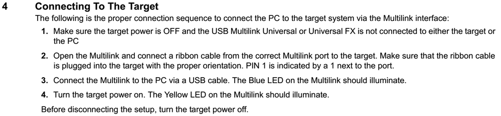

2) Again, most probably you have checked it, but just to make sure, do you see both LEDs ON when connecting your Multilink?
3) You connected GND to PIN 4 of Multilink. The ARM JTAG interface specs recommend to connect all the GND pins, not only pin 4 (pins 4/6/8/10/12/14/16/18/20). This is to reduce noise.\

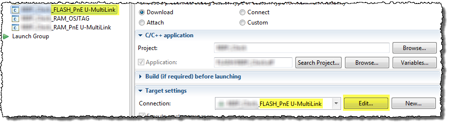

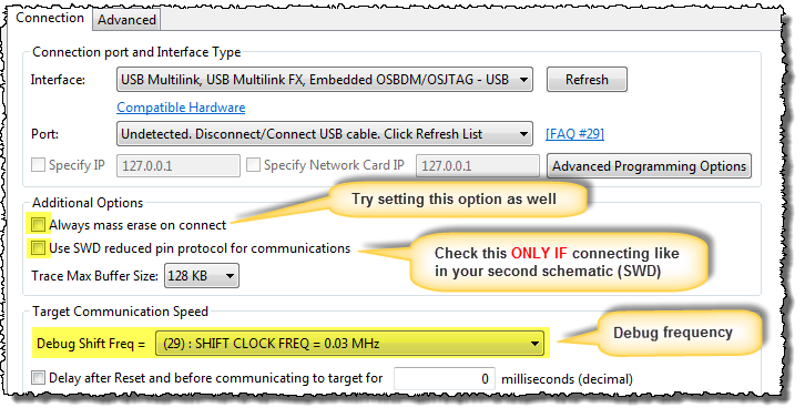

5) Try reducing the PE Universal Multilink debug speed. This can be done from the tab Run -> Debug Configurations -> Edit. As your MCUs are brand new, I also recommend to check the "Always mass erase on connect" option. And last, for your second schematic (using SWD instead of JTAG), you have to make sure to select the "Use SWD ..." option. See the next images for these comments:
6) And finally, I have known of cases in which the debug configurations get corrupted. Easiest way to discard this is to create a new empty bareboard project and trying to program this in your MCU, but considering my points above as well.

2. As per the multilink universal guideline i.e its given below, I followed and ensured both the LEDs are glowing.

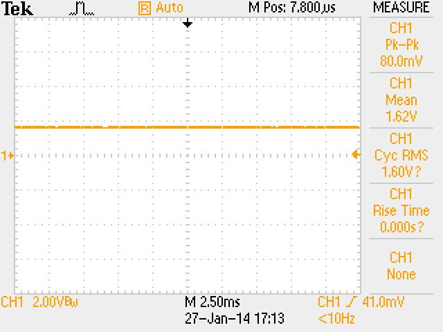

5. According to the 1st schematic, value for R1(resistor to reset pin) is 1K. when I probe this pin, In normal condition I get 1.64V and when the programming starts it becomes (0V). Is that expected?? I mean the voltage 1.64v? or should it be higher?

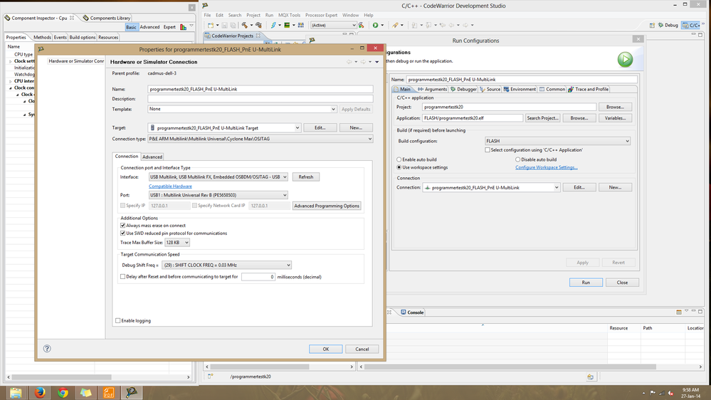

6. I tried your 5th point i.e 1st checked for SWD, and then for JTAG.
7. I tried making empty bareboard project and programming it.
In this case It didn't asked for secure, it directly stated that multilink is not communicating i.e 2nd image which I shared in my 1st post.
The above configuration is for SWD now Trying for JTAG. It still didn't worked. what should I do next?
If the device is resetting, this may solve the issue:
- Make sure to select "Always mass erase on connect", and select a not so high debug frequency (e.g. 0.10 MHz).
Then follow the next steps:
1) Disconnect the board from your 3.3 V source.
2) With a jumper force the reset pin to a low level (GND) and hold it.
3) Power on the board (connect the 3.3 V source). Do not release reset yet.
4) Start a debug session and as soon as it is starting release the reset button.
Try this more than once.
Additionally, you could also try mass erasing the K20 device from the Flash programmer. Just open the programmer, select proper connection and specific flash configuration file and then click on "Erase Whole Device".
If the Erase is successful, then you should be able to debug.

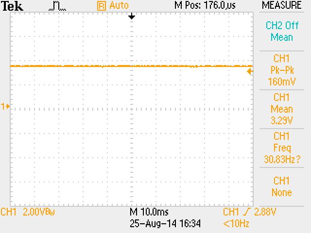

For the reset pin I was also doubtful so I soldered the pinout board for KL05 and checked for the reset pin there. On kl05 reset pin I got 1.64v. for the reset pin if I am not connecting any capacitor then getting the following pulse
after connecting the 1uf capacitor I am getting the following waveform
Now what you suggest me to do ? These voltages are when multilink is not connected to the uc. even after connecting the same results exist. These waveforms are common for both k20 and kl05 uc.
Amit Kumar
