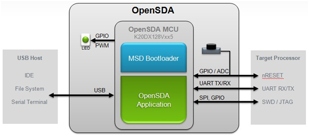

OpenSDA/OpenSDAv2 is a serial and debug adapter that is built into several Freescale evaluation boards. It provides a bridge between your computer (or other USB host) and the embedded target processor, which can be used for debugging, flash programming, and serial communication, all over a simple USB cable.
The OpenSDA hardware consists of a circuit featuring a Freescale Kinetis K20 microcontroller (MCU) with an integrated USB controller. On the software side, it implements a mass storage device bootloader which offers a quick and easy way to load OpenSDA applications such as flash programmers, run-control debug interfaces, serial to USB converters, and more. Details on OpenSDA can be found in the OpenSDA User Guide.
The bootloader and app firmware that lay on top of the original OpenSDA circuit was proprietary.  But recently ARM decided to open source their CMSIS-DAP interface, and now a truly open debug platform could be created. This new open-sourced firmware solution is known as OpenSDAv2.
OpenSDAv2:
OpenSDAv2 uses the exact same hardware circuit as the original OpenSDA solution, and out of the box it still provides a debugger, drag-and-drop flash programmer, and virtual serial port over a single USB cable.

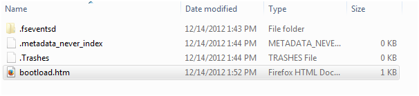

You can determine the bootloader version by holding the reset button while plugging in a USB cable into the OpenSDA USB port. A BOOTLOADER drive will appear for both OpenSDA and OpenSDAv2.
The OpenSDAv2.0 bootloader (may also be called the CMSIS-DAP/mbed bootloader) developed by mbed.org will have the following files inside.  Viewing the HTML source of the bootload.htm file with Notepad will tell you the build version, date, and git hash commit. For the OpenSDAv2.1 bootloader, this file will be named mbed.htm instead.
The OpenSDAv1 bootloader developed by P&E Micro will have the following inside. Clicking on SDA_INFO.HTM will take you to the P&E website.

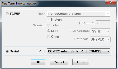

2.Virtual Serial Port
OpenSDAv2 will also enumerate as a virtual serial port, which you can use a terminal program, such as TeraTerm (shown below), to connect to. You may need to install the mbed Windows serial port driver first before the serial port will enumerate on Windows properly. It should work without a driver for MacOS and Linux.

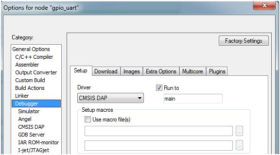

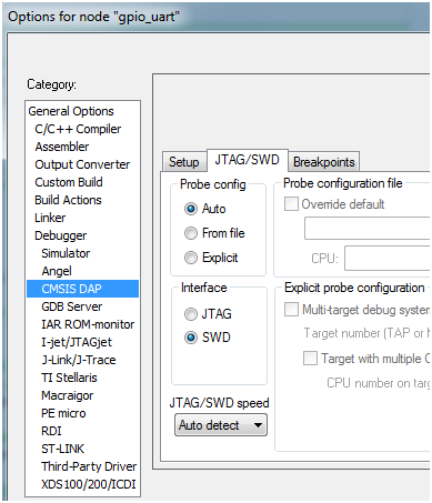

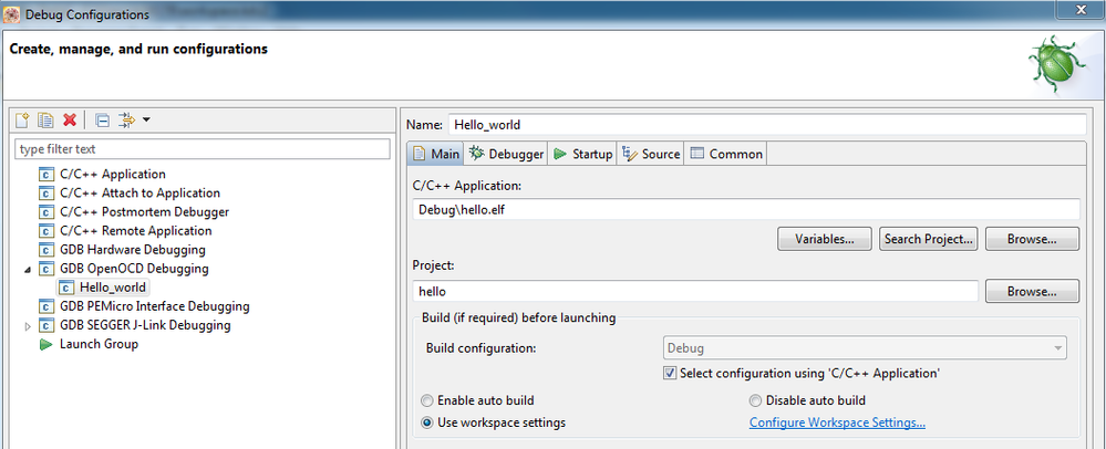

3. Debugging
The CMSIS-DAP app also allows you to debug the target MCU via the CMSIS-DAP interface. Select the CMSIS-DAP interface in your IDE of choice, and inside the CMSIS-DAP options select the Single Wire Debug (SWD) option:

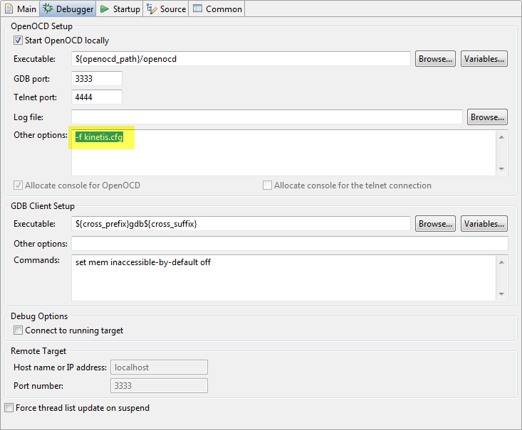

Kinetis Design Studio (KDS):
Note: OpenOCD with CMSIS-DAP for FRDM-K22F is not supported in KDS V1.1.0. You must use either the P&E app instructions or the JLink app instructions to use KDS with the FRDM-K22F at this time. This will be fixed over the next few weeks.
OpenSDAv2 uses the OpenOCD debug interface which uses the CMSIS-DAP protocol.
Make sure '-f kinetis.cfg' is specified as 'Other Options':
IAR
Keil:

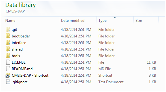

The code is found in the MBED git repository, so it can be downloaded using a git clone command:
“git clone https://github.com/mbedmicro/CMSIS-DAP.git
Note that there is a Download Zip option, but you will run into a issue when trying to compile that version, so you must download it via git instead.
The source code can be seen below:
This repository contains the files for both the bootloader and the CMSIS-DAP debug interface application. We will concentrate on the interface application at the moment.

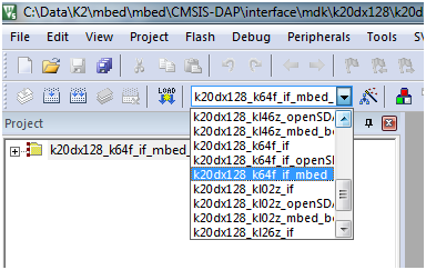

Open up Keil MDK, and open up the project file located at \CMSIS-DAP\interface\mdk\k20dx128\k20dx128_interface.uvproj
In the project configuration drop-down box, you will notice there are a lot of options. Since different chips may have slightly different flash programming algorithms, there is a target for each specific evaluation board. In this case, we will be building for the FRDM-K64F board. Scroll down until you get to that selection:
Notice there are three options for the K64:
  • k20dx128_k64f_if: Used for debugging the CMSIS-DAP application with Keil. Code starts at address 0x0000_0000
  • k20dx128_k64_if_openSDA_bootloader: Creates a binary to drag-and-drop on the P&E developed bootloader (Original OpenSDA)
  • k20dx128_k64_if_mbed_bootloader: Creates a binary to drag-and-drop onto the CMSIS-DAP/mbed developed bootloader (OpenSDAv2)
Since the FRDM-K64F comes with the OpenSDAv2 bootloader, we will use the 3rd option. If we were building the mbed app for another Freedom board which had the original OpenSDA bootloader, we would choose the 2nd option instead.

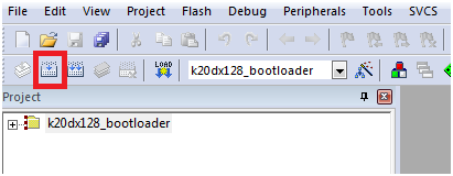

Now click on the compile icon. You may get some errors
  • If you get an error similar to the one shown below, make sure you have installed the Legacy pack for ARM as previously described earlier:
          compiling RTX_Config.c...
            ..\..\Common\src\RTX_Config.c(184): error:  #5: cannot open source input file "RTX_lib.c": No such file or directory
         and
        compiling usb_config.c...
            ..\..\..\shared\USBStack\INC\usb_lib.c(18): error:  #5: cannot open source input file "..\..\RL\USB\INC\usb.h": No such file or directory
  • If you get an error regarding a missing version_git.h file, make sure that Python 2.x and git are in your path. A Python build script fetches that file. It's called from the User tab in the project options, under "Run User Programs Before Build/Rebuild".
  • If there is a warning about “invalid syntax” when running the Python script, make sure your using Python 2.x. Python 3.x will not work with the build script.

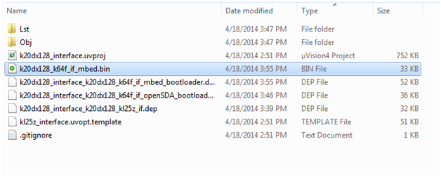

Now recompile again, and it should successfully compile. If you look now in \CMSIS-DAP\interface\mdk\k20dx128 you will see a new k20dx128_k64f_if_mbed.bin file
If you compiled the project for the OpenSDA bootloader, there would be a new k20dx128_k64f_if_openSDA.S19 file instead.

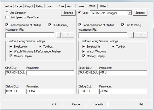

Now connect a Keil ULink to J10 and then insert a USB cable to provide power to J26. Note that if you have the 20-pin connector, you’ll want to use the first 10 pins.

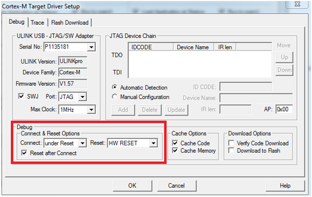

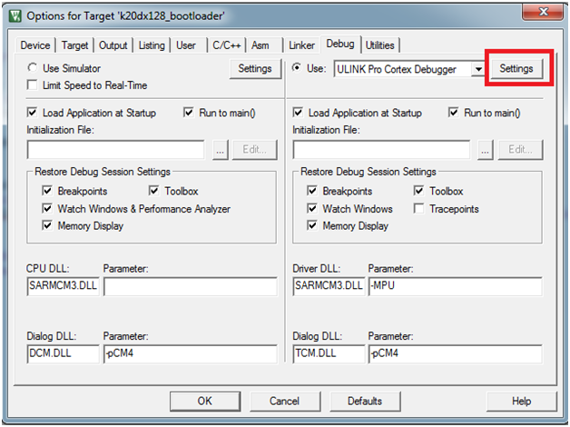

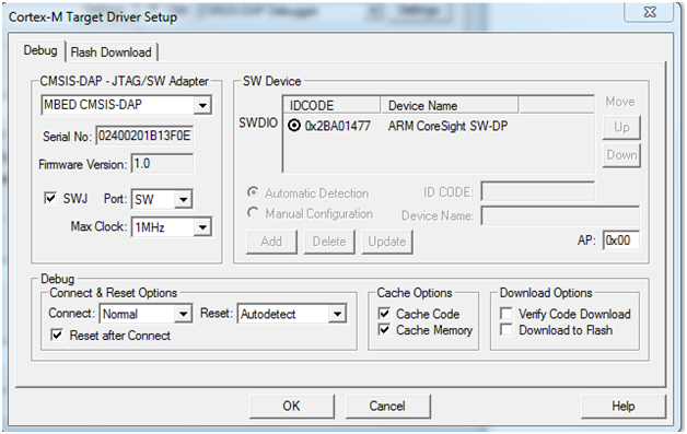

Then for Keil 5 you will need to change some debug options (CMSIS-DAP is built under Keil 4.x).
Right click on the bootloader project, and go to the Debug tab and next to ULINK Pro Cortex Debugger, click on Settings:
Then under “Cortex-M Target Driver Setup”, change the “Connect” drop down box to “under Reset” and “Reset” dropdown box to “HW RESET”. Hit OK to save the settings.
