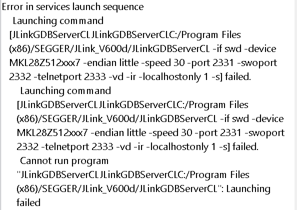

I have been trying as you suggested ... unfortunately, I have still an error with GDB trying debugging the Hello-World example for the FRDM-KL28. The error is:
So, i have de-install and re-install KDS 3.2.0 and JLink - V600 but to no avail.  I haven't changed anything in the debugger setting of the Hello-World example. The board is connected to Tera Term with success and the OpenSDA 2.1 seems to be loaded correctly (as for Tan, I don't see the disk drive).

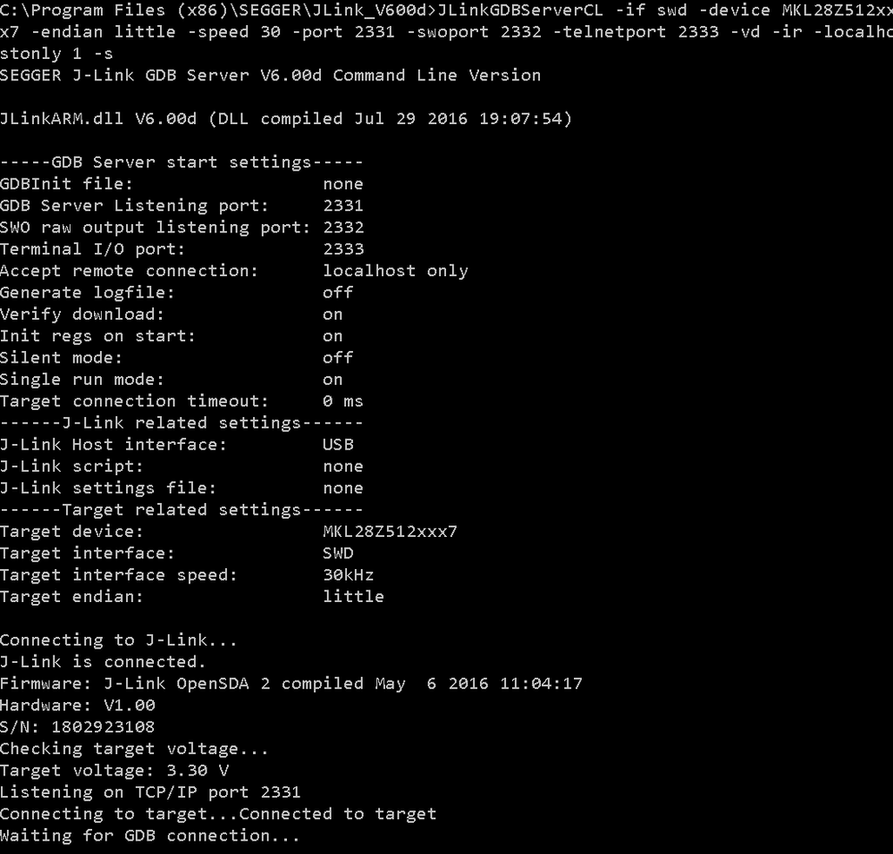

Starting the command above in a prompt gives this:
Any suggestion ? Thank you.

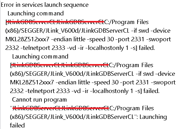

Hi Andre,
It seems that the issue is resulted from the command that KDS calls JLink GDB Server. I find there are additional contents in the command from the error report you provided. Please see the below figure.
Do you run the hello_world demo from "SDK_2.0_FRDM-KL28Z" and made no changes of the project?

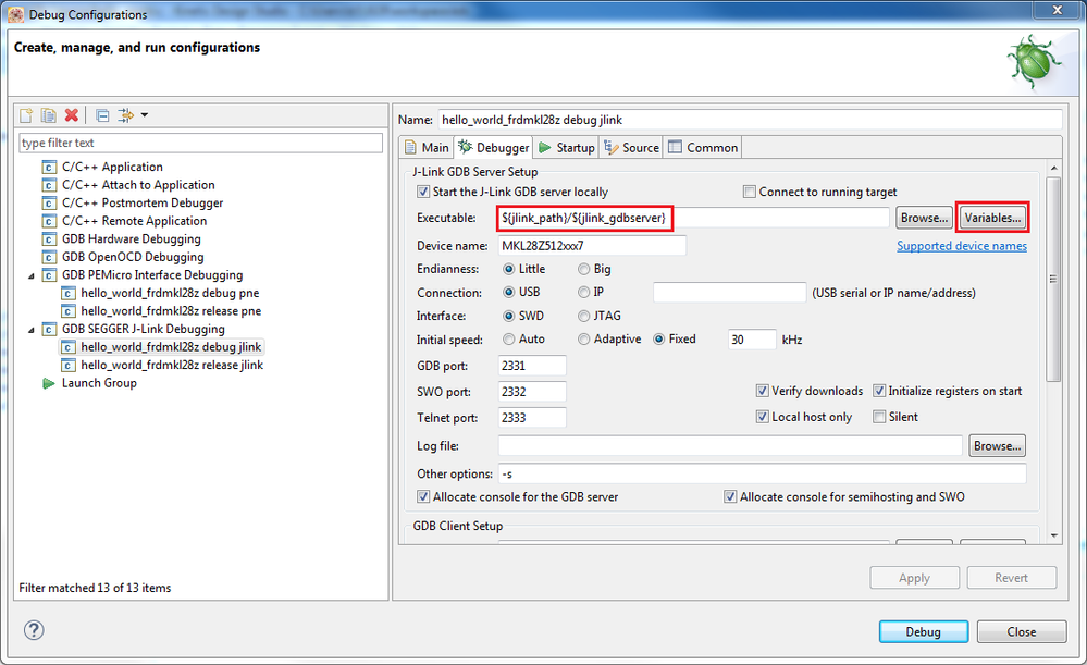

Could you provide the debug configurations information followed the below steps?
1. Import the hello_world project to you workspace.
2. Click the small downward arrow next to the green "Debug" button and select "Debug Configurations".
3. In the Debug Configurations dialog box, select debug configuration “hello_world_frdmkl28z debug jlink”. Then click the "Debugger" tab to open the debugger configuration page.
4. Please let me know the content in the text box next to the "Executable" label. Is it  "${jlink_path}/${jlink_gdbserver}" just like mine? If not, please modify it as mine and then try the debugging process again. If it is, please proceed the followed steps.

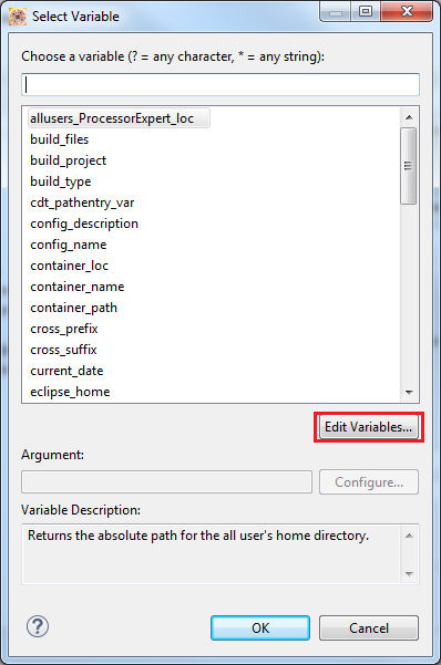

5. Click the "Variables..." button to open a new window. Then click the "Edit Variables" button to open another window.
6. Please feedback me the value of the "jlink_path" variable.

valeremar
Dear Dean,
thank you very much for your feedback.
I made no change to the project. My folder is named SDK_FRDM_KL28Z.
No it was:  ${jlink_gdbserver}${jlink_gdbserver}${jlink_path}/${jlink_gdbserver}. So I have changed the path to
${jlink_path}/${jlink_gdbserver} and it works. I have just noticed that clicking the "Variables ..." button of the GUI and closing the new pop-up window  by clicking "OK" (and not Cancel), always add a variable name to the executable variable field and that although the variable name does not appear on the field just below the "Choose a variable" of the pop-up window... it might have happened to me inadvertently while checking if the JLink path was correct in KDS ?????
My path is C:/Program Files (x86)/SEGGER/JLink_V600d
