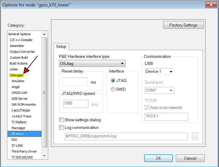

I'm just trying the  IAR Embedded Workbench IDE. When I want to download the code on the TWR-K70 do I need a J-link or like CW there 'is  an Open Source JTAG solution ?
I'm looking forward to your answer !

Hi Jay,
Yeah you can use On-board JTAG debug circuit. You have only to check in your project that PE Micro is selected in Debugger tab and then OSJTag is set as hardware interface in PE micro tab, see screenshot below.
Antonio
