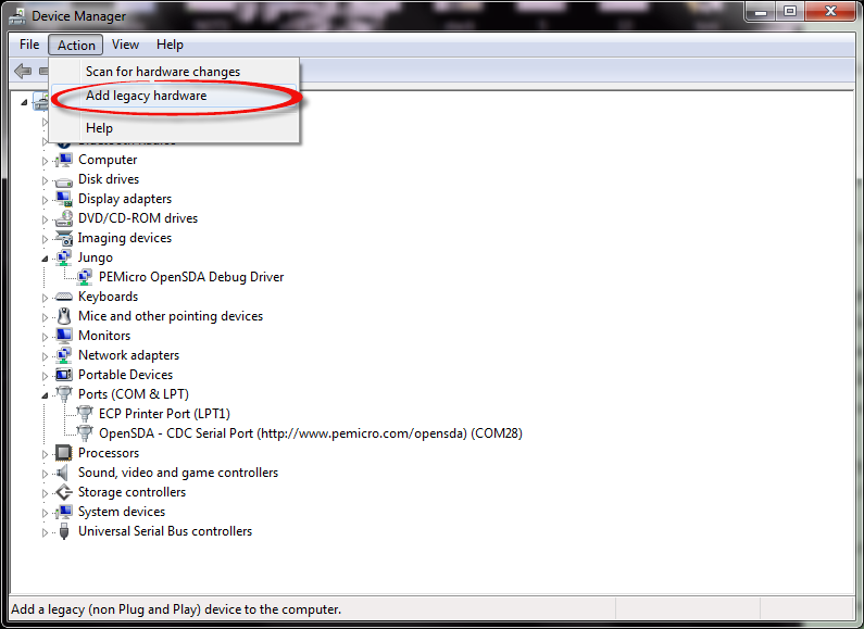

Hi sam moreland,
please, what tutorial do you tried? Did you try proceed according to these steps? OpenSDA on the Freedom KL25Z Board | MCU on Eclipse
Iva

ivadorazinova
Hi sam moreland,
Have you tried to update driver manually?
ok - if you follow all of mentioned steps, please, tell us exact procedure what are you doing.
Iva

ivadorazinova
Dear sam moreland,
I created screenshots for you. Please, follow it.
I hope it helps you,
Iva

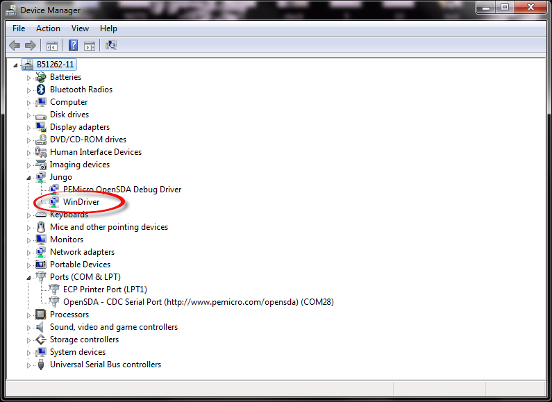

ivadorazinova
Hi sam moreland,
yes. You also  need to install WinDriver in Jungo. The procedure is the same, but you choose WinDriver.
Here is step by step manual:
Iva

sammoreland
Im afraid that still isn't working, I originally had that driver installed and uninstalled it when testing different configurations. Please see the screenshot below. I am also unable to take down firewalls/anti-virus at work as it is against company policy. device man.png

ivadorazinova
Hi sam moreland,
yes.  The drivers are ok.
Please, also, did you try the board on another computer or did you try another board?
Iva

adriancano
Your Device Manager does not show the WinDriver under the Jungo tree, please check this post it might be useful:
Fixing the USB Drivers | MCU on Eclipse
Hope this information can help you
