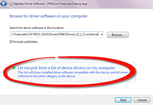

I have followed all the tutorials/posts/freescale opensda guides for installing the debug app and have followed them to the letter, however my freedom board driver does not successfully install when enumerating.
As far as I'm aware my board is up to date (see below)
(boot-loader V 1.11, debug V 1.14)
I have also installed the latest driver (V11.1) which has installed on my C drive.
I have tried updating the driver both with automatic windows detection and by browse, physically pointing to the folder which holds the driver, with neither working. Has anyone else had this problem/no how to fix it.

1. Start the device in MSD mode (holding reset button while powering up)
2. Opened SDA_INFO to check the version I had on the board.
3.Dowload and installed latest windows USB drivers (V.11.1) from the P&E micro site
4. Downloaded the Firmware Apps.zp file from the P&E micro site and extract locally on the computer
5. Drag and drop the latest debug app version "MSD-DEBUG-FRDM-KL02Z_Pemicro_v114.SDA"
6. Cycle power (remove and replace usb cable), box pops up saying unable to install drivers
7.Check in device manager for it to enumerate as a serial port, which it doesn't. Also check by trying to debug in codewarrior (V10.6) which cant see it (checking though all port connection in the P&E connection assistant, including "OpenSDA - USB Port")
8.Start the device in MSD mode (holding reset button while powering up)
9. Drag and dropped the latest firmware version "BOOTUPDATEAPP_Pemicro_v111.SDA"
10. Cycle power (remove and replace usb cable), box pops up saying unable to install drivers and double check codewarrior which is still unable to see it.
In device manager its just appears in other devices with the driver status being "The drivers for this device are not installed. (Code 28)"

Dear sam moreland,
I created screenshots for you. Please, follow it.
I hope it helps you,
Iva
5,681件の閲覧回数

ivadorazinova
Hi sam moreland,
yes. You also  need to install WinDriver in Jungo. The procedure is the same, but you choose WinDriver.
Here is step by step manual:
Iva

sammoreland
Im afraid that still isn't working, I originally had that driver installed and uninstalled it when testing different configurations. Please see the screenshot below. I am also unable to take down firewalls/anti-virus at work as it is against company policy. device man.png

adriancano
Your Device Manager does not show the WinDriver under the Jungo tree, please check this post it might be useful:
Fixing the USB Drivers | MCU on Eclipse
