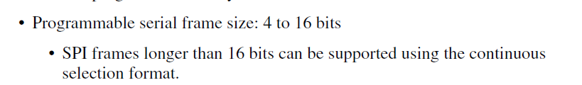

What is the maximum number of bits that can be transferred in a single SPI operation on a K64? The reference manual says: "The module is in SPI configuration when the DCONF
field in the MCR is 0b00. The SPI frames can be 32 bits long." However, the FMSZ (frame size) field in the SPIx_CTARn register is only four bits wide, which would imply a maximum frame size of 16 bits.

    From the K64 reference manual,  register SPIx_PUSHR description, you will get that:
In Master mode, the register transfers 16 bits of data and 16 bits of command information.In Slave mode, all 32 bits can be used as data, supporting up to 32-bit frame operation.

I think the question was about the frame size (<=16) as can be set in the register SPIx_CTARn in the FMSZ bit-field . Can you, for example set 4-bit,5-bit,6-bit,7bit, 8bit... 16bit mode and be sending those many bits per frame? while still under 16 bits in length?

Please check the reference manual description:
 Each frame bit size is determined by SPIx_CTARn in the FMSZ bit-field. it can send 4-bit,5-bit,6-bit,7bit, 8bit... 16bit per frame.
But, if you need the frame size is larger than 16bits, you need to use the continuous format.
