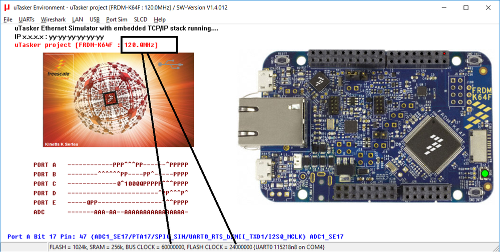

Probably the firmware is expecting the 50MHz oscillator input from the PHY and so will wait forever for the input signal to "become valid". The code doing this will be running from the default clock.
You can use the HIRC (internal 48MHz oscillator) as PLL reference to generate the same 120MHz core frequency instead.
If your environment is not flexible you can use the following code (taken from the uTasker project for FRDM-K64F, which supports all possible configurations). You will need to be aware of a chip errata in older K64s that require the USB controller to be enabled too in order for the HIRC to work (workaround also shown below).

The actual register values (if the defines are not understandable) to run at 120MHz core, 60MHz bus and 24MHz flash clock (see uTasker FRDM_K64F simulation below) are:
MCG_C7 = 0x02;
SIM_CLKDIV1 = 0x01240000;
MCG_C1 = 0x84;
// wait until the new source is valid (move to FBI using IRC48M external source is complete)
MCG_C1 = 0xb0;
MCG_C5 = 0x33;
MCG_C6 = 0x5a;
// loop until the PLLS clock source becomes valid
// loop until PLL locks
MCG_C1 = 0x28;
// loop until the PLL clock is selected
I have also attached a FRDM-K64F binary that you can load to the board in case you need to reverse engineer on the board. It has a command line interface on the VCOM UART and on the K64's USB (USB-CDC) and there are low power menus in the "administrator" menu in case you would like to check the power consumption possible in the various modes based on this clock configuration.
