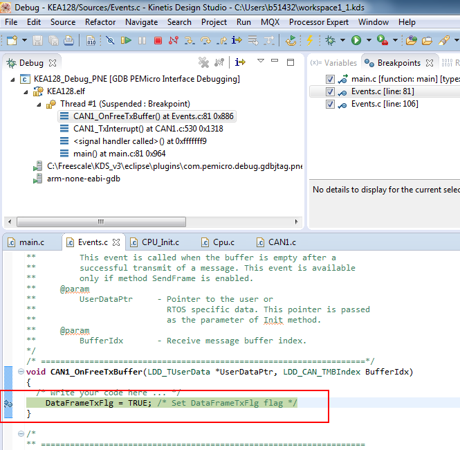

Hello Pedro,
Please check the initialize code whether it enable the CAN TX interrupt , if not ,
please add the code :
If still can not work , please tell me which IDE and which version do you use ,and use the oscilloscope to check
whether it have signal on can PIN .
Hope it helps
Alice

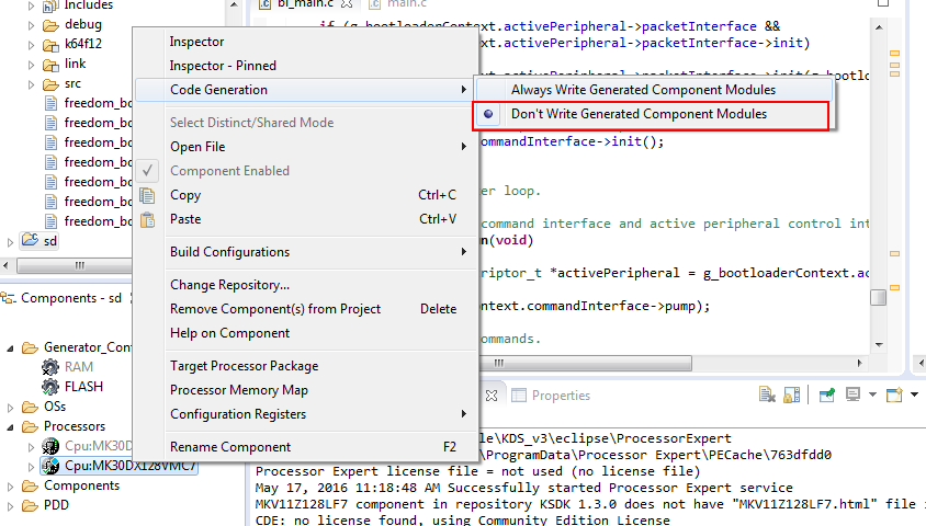

Hello Pedro,
- After you add the enable Tx interrupt code to the CAN initialize function , please
enable the "don't write generated component modules" of CAN module :
- About the frdm-kea128 board ,why you said need setup SPI ?
Alice

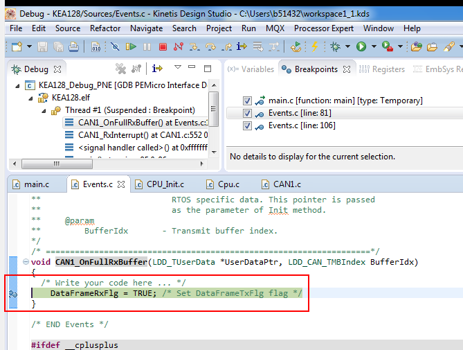

I also create one project on KDSv3.2 refer to this thread , it can work well , it can run to the interrupt
CAN1_OnFreeTxBuffer
and CAN1_OnFullRxBuffer
The project please check the  attachment .
