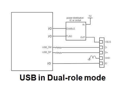

Hui_Ma
Hi Kaitav,
About Q1&Q3, the answer is Yes, if customer need reality USB OTG function,  K60 USB module need connect with external OTG capacity PHY chip , such as MAX3353.
The USB dual role diagram is using USB mini-AB connector.
More detailed info, please check below picture:
Wish it helps.
9,923 Views

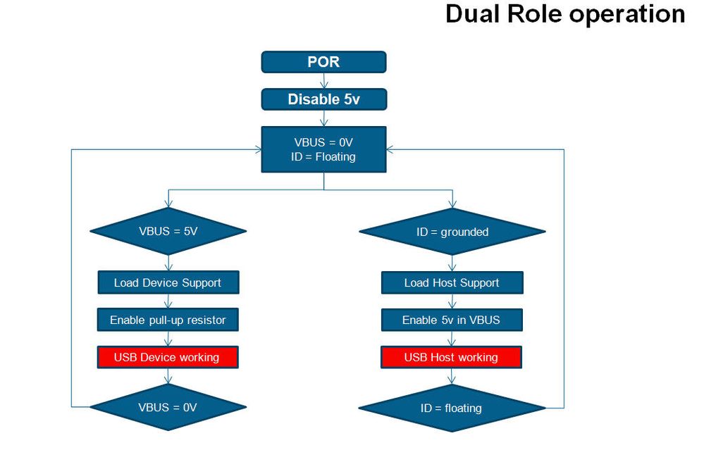

Hui_Ma
Hi Kaitav,
I think you can use Micro-AB connector for dual-role function, which is same with Mini-AB connector.
When it connect with Host converter, the ID pin is grounded and the software will recognize it as USB host mode, otherwise software will deal it as USB device.
With USB dual role function, there is no support HNP and SRP protocols, which means it could not support interchange host and device roles dynamically without losing connection.
The USB dual role function operation based on below picture shows.
Wish it helps.
9,923 Views

Hui_Ma
Hi Kaitav,
Thank you for the patience.
A1> For the dual role mode, the ID pin connect to a GPIO pin, it need to detect GPIO related register to get the ID state. USB attach/detach status could be get from Interrupt Status Register (USBx_ISTAT).
VBUS generated controlled via GPIO pin, about VBUS voltage detect based on external regulator chip and related circuit, could use ADC pin to detect VBUS voltage.
A2> You understanding is quite correct.  With OTGEN bit 0 value, the pull ressitor is auto connected if USB_EN is set and HOST_MODE is clear in the Control Register (CTL).
A3> When operating in USB device mode, it is ok to keep the D+ pull up resistor pull up during the USB communication.
Wish it helps.

Hui_Ma
When the USB in dual-role mode, the VBUS voltage detect via a GPIO pin is better than using ADC pin.
About how the Kinetis MCU know USB attach/deattach, in fact, after the another USB device/host connects with the board, the board will according VBUS/ID state to detect which mode will be, host or device.
Then after the USB module initialization, the USB attach/deattach interrupt will generate.
In related USB interrupt service routine, the Kinetis MCU will know another USB device/host connected.
In fact, the OTG related register will not be used for USB operation.
Wish it helps.

Hui_Ma
Hi Kaitav,
The board ID pin will determine which USB mode the dual role board will be. When the ID pin is 0, the software will run USB host mode. After that, the USB module will be initialized and when there with USB device attached/deatach, the related interrupt will be triggered. The USB mode determined by ID pin status, is not very accuracy. In my mind, the board will run USB mode checking routine always, until which status become true. Then, the board will run USB host related software or USB device related software. If there with no cretain confirmed status from default(VBUS = 0V and ID = Floating), the software will in USB mode checking routine always.
The OTG related register will not be used, which use USB related register instead, such as Interrupt Status Register (USBx_ISTAT).
