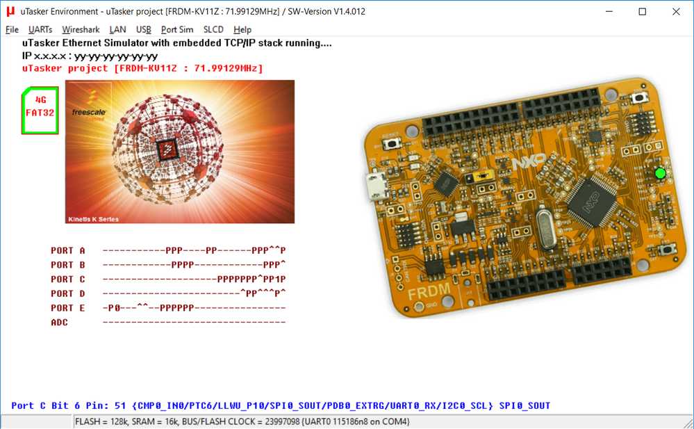

With Visuals Studio it can also be tested (simulates the board, the KV11 and the SD card) if build from the uTasker project:
If you measure the signals you can also see a reference as to what is sent to the card so that you can work on solving the porting problems.
This is a standard solution in the uTasker project that works on any Kinetis part (with enough memory for a FAT - on any SPI or SDHC) without porting requirements (and on memory sticks when USB host is available). It allows professional projects to benefit from immediate complete and mature solutions rather than requiring porting from examples (projects can also be switched between processors without needing different libraries and re-porting efforts)
