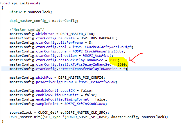

I finally got it working!
The issue was related to DSPI SCK driving. The problem has been solved when I added below delays (current values are given for default SDSPI baudrates, you may need to change them for different initial SPI speeds.).
I had to write my own routine to test the sd card by the CMD0 and check the R1 response. I realized that the SCK was skipping one low sequence between consecutive bytes. So I changed the delay configurations of the DSPI driver library in spi_init function.
By the way, there is no SDSDPI middleware library for MKV11, I migrated the MKV10 files to MKV11.
For anyone who has the same problem; I attached my MKV11 project which includes this migrated library to the first post, it works for me. The main routine has 2 option, first is to test the CMD0 command manually after calling the spi_init function. The second option is to use the FAT, you can enable the first option and scope the signals if you have a problem. Sorry the source code is a mess since it just worked and I didn't need to beautify it for now, but I guess it will be easy to understand the basics.
I used SDK 2.6.0 for MKV11 in MCUXpresso IDE and 4GB Fat32 SanDisk SD Card. By the way, I had 47K pull-ups on the MOSI, MISO and SCK lines but it didn't work until I replace them with 10K ohms.

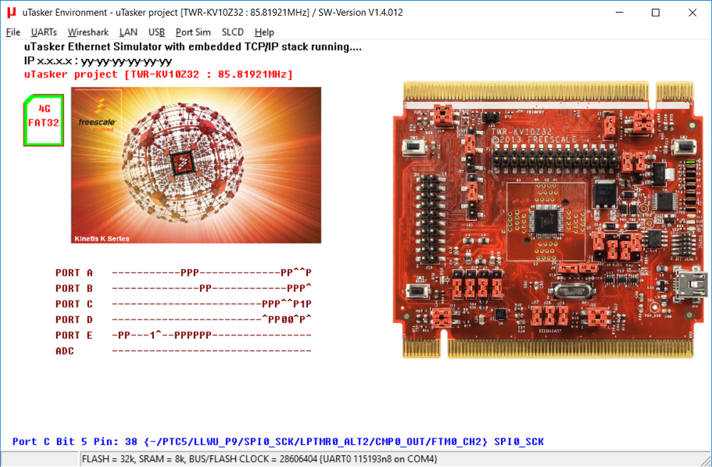

http://www.utasker.com/kinetis/TWR-KV10Z32.html
http://www.utasker.com/docs/uTasker/uTasker_utFAT.PDF
Open source solution for KV and FAT: Open Source version at https://github.com/uTasker/uTasker-Kinetis

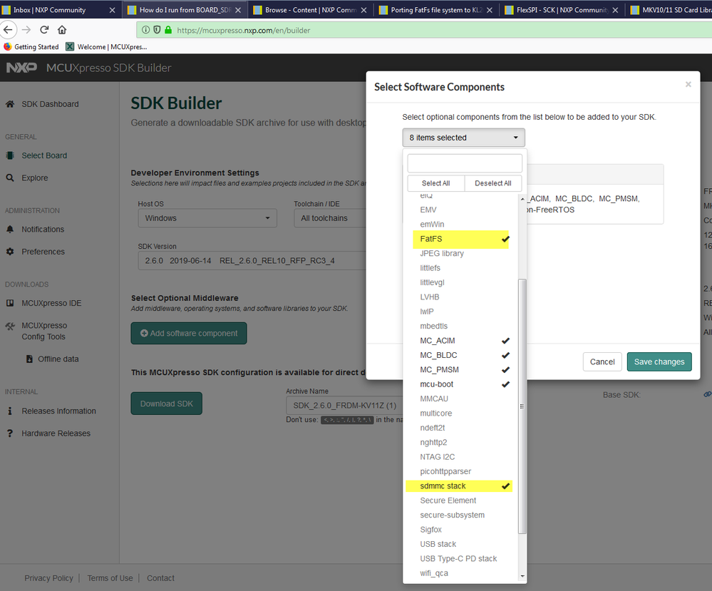

kerryzhou
Hi Abdullah Çınar,
Please check the following information, maybe useful to you:
1. Porting FatFs file system to KL26 SPI SD card code
2. SDK code for KV11, select the fatfs and sdmmc
https://mcuxpresso.nxp.com/en/builder
Then, you can find the related driver in this folder: SDK_2.6.0_FRDM-KV11Z\middleware
Wish it helps you!
Kerry

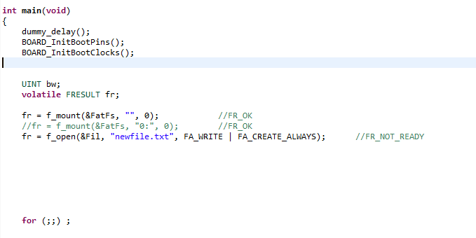

abdullah_cinar
Hi Kerry,
I included all the necessary files from the Kinetis SDK FatFS folders to my project. I am trying to run the "fsl_sdspi_disk".
I filled up the necessary configuration defines (spi_base, spi_cs).
I added the pin mux calls to init boot pin settings.
When I get an error when I try to open a new file. Do you know where to start testing the library to know the cause of the error?
Below is the routine in my main.c file. I get "FR_OK" when I call "f_mount" but I get "FR_NOT_READY" when I call "f_open".

kerryzhou
HI Abdullah Çınar
When you meet the problem, I think you need to check the SD card initialization code at first, can you connect to the SD card, and do the sd card read and write operation? When that function works, then you can add the fatfs again.

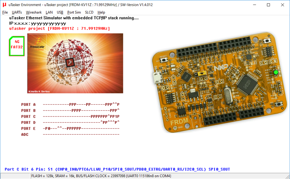

If you have a FRDM-KV11Z board you can load a reference binary (attached) which adds SD card support to the following pins:
PTC5 = SPI0_CLK
PTC6 = SPI0_SOUT
PTC7 = SPI0_SIN
PTC1 = chip select
On the OpenSDA VCOM UART there is a DOS-like interface (115kBaud) [menu 8 - utFAT Disk Interface] which allows formatting, listing card content, moving between directories, creating, renaming, etc and also viewing details of files and their objects.

With Visuals Studio it can also be tested (simulates the board, the KV11 and the SD card) if build from the uTasker project:
If you measure the signals you can also see a reference as to what is sent to the card so that you can work on solving the porting problems.
This is a standard solution in the uTasker project that works on any Kinetis part (with enough memory for a FAT - on any SPI or SDHC) without porting requirements (and on memory sticks when USB host is available). It allows professional projects to benefit from immediate complete and mature solutions rather than requiring porting from examples (projects can also be switched between processors without needing different libraries and re-porting efforts)

kerryzhou
Hi Abdullah Çınar,
  You need to debug the disk_initialize, disk_write and disk_read in the diskio.c at first, if these function can works OK, it means your SD card communication is OK, otherwise, you still need to check the sd card communication level, not the fatfst file side.

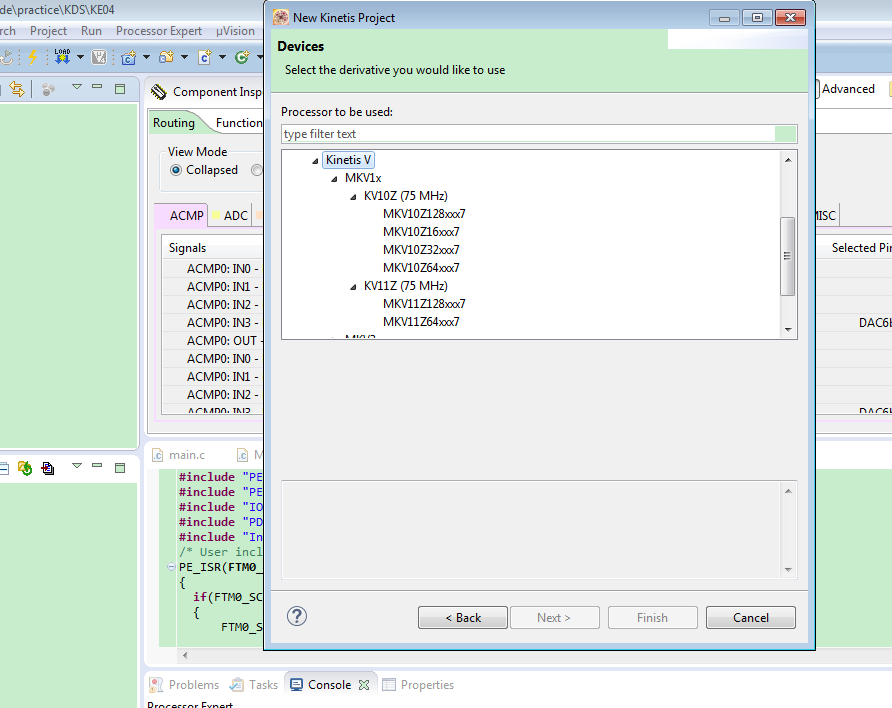

By the way, if I change the device from MKV10Z32 to MKV11Z64, I can add FatFs and I can not select Kinetis Design Studio. Do you know why?
If it is not possible to proceed with MKV11, I will start with MKV10 and then try to use the drivers in the MKV11 since the APIs are similar.
Abdullah.
10,272 Views
kerryzhou
Hi Abdullah Çınar,
  I have checked the KDS, both KV10 and KV11 is supported.
So you KV11 can use KDS IDE, but now, KDS won't update the new chip, we have transferred to the MCUXpresso IDE.
Wish it helps you!
Kerry
10,272 Views
abdullah_cinar
Hi Kerry,
I already use KDS for KV11, but I couldn't add the FatFS middleware to SDK package of KV11. But it's okay, I downloaded the FatFS middleware for KV10 and I translated them since I'm also familiar with KV10.
