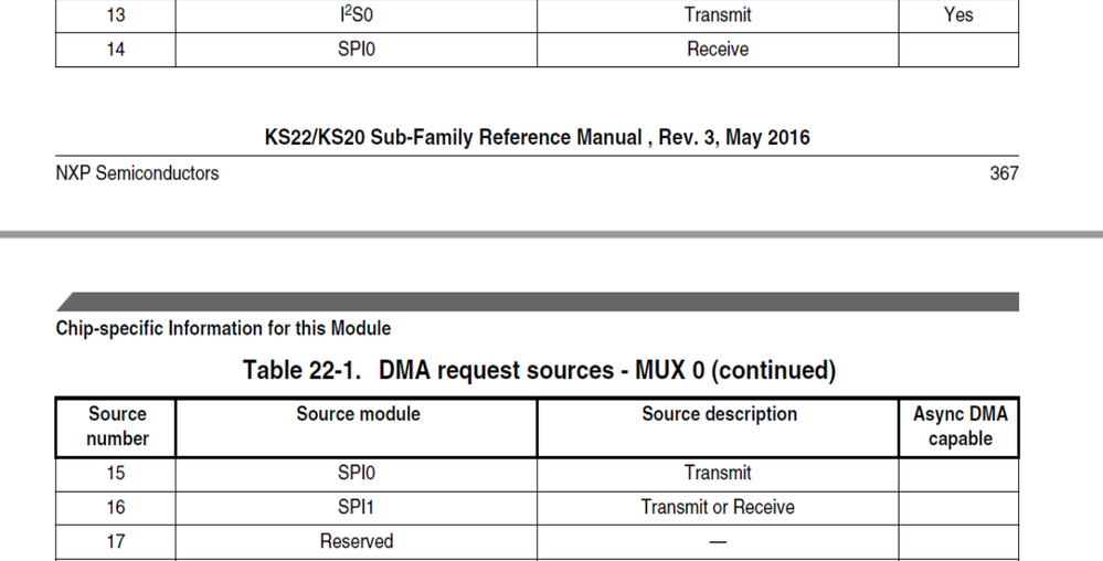

I'm trying to use multiple DMA channels to fill PUSHR and empty POPR on _both_ SPI modules of an MKS22.
SPI0 is working fine but SPI1 is not behaving as expected.
If I only use DMA to fill PUSHR, that works fine.
I noticed that the MKS22 only has one DMA request line for SPI1 so it looks like it isn't possible to use DMA for both TX and RX for SPI1. Is that right? Is there a workaround?
3,457 Views
miduo
Your understand is correct. From the reference manual, Table 22-1, there listed that SPI0 use dedicated DMA source numbers for TX and RX. However, for SPI1, the DMA source are shared( Transmit or Received).That is the reason why your situation is.
