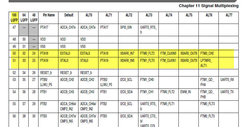

MKV46F256VLL16  芯片的 外部 时钟输入 引脚 位置 在Pinout中 没有标示 ,请问在那两个 引脚

Hi Wang Ming,
    Please check the reference manual: 11.5 KV4x Signal Multiplexing and Pin Assignments
Wish it helps you!
If you still have any question about it, please let me know.
Kerry

dear Kerry:
at first , I can not find "Mark Correct" button in the community.
then , i have another question ,: I want to product 6 channel PWM signal to control motor , but I can not make sure the right out pins.
whare I can get sample code or driver soft abut PWM control. thanks a lot.
the MCU is MKV42F256VLL16 .

Hi Wang ming,
   For the detail PWM pin, you can use the PWM module, which you can find it from chapter Chapter 37
Pulse Width Modulator.  pin is 37.3.1 PWM[n]_A and PWM[n]_B - External PWM Output Pair.
You also can use the FTM module, the channel is FTM_CHn
Wish it helps you.

Hello Ming,
If you want to use a motor with H-bridge, you should use complementary mode of the PWM .
See in the chip Referance Manual section 38.3.1:
38.3.1 PWM[n]_A and PWM[n]_B - External PWM Output Pair:
These pins are the output pins of the PWM channels. These pins can be independent
PWM signals or a complementary pair.

1410385858
but I can not find the pin function in the pin out list.

Hi Wang,
   Maybe you can consider the FTM channel, then you can find the pin function still in the reference manual:
