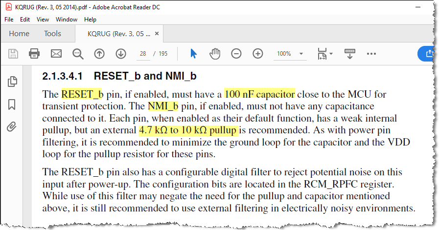

Hi, I am drawing my first MK22FN1M0AVLH12 board for a IO triggering interface. I have read through the reference design for FRDM-K28 & K22P64M120SF5V2RM as reference for my schematic.
I am just wondering if anyone could advise on my MCU diagram especially my JTAG connect & crystal osc. Thanks.

Hi  mylim,
RESET_b
NMI_b
VREGIN
VOUT33
Analog power supply
You can refer the circuit of TWR-K70F120M
Robin

Thank you very much. Luckily I haven't send my PCB out to produce.
I wonder why the information you have on the K22P121M120 document couldn't be found in K22P64M120.
