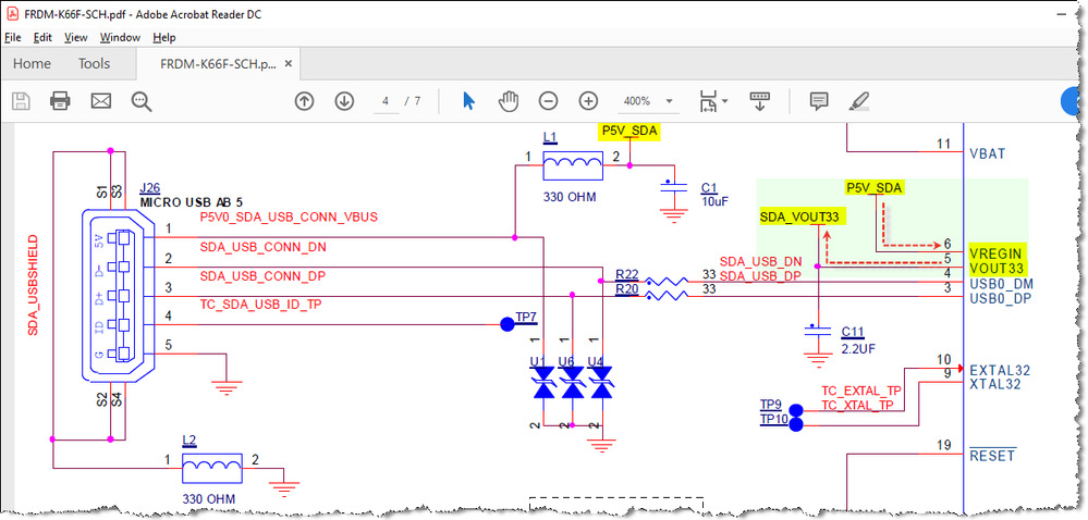

Hello Team,
I have a question regarding the power distribution of K66F schematics. If I power the board through the openSDA usb connector, the P3V3_SDA is powered through U17 which means J18 should shorted by R61. However, I find that both R84 and R61 is not populated on the board. Can you tell me where the power of P3V3_SDA is from if J18 is not connected. Also, I found that SDA_VOUT33 is not connected too.
Hao

P3V3_SDA is powered through J7(SDA_VOUT33).

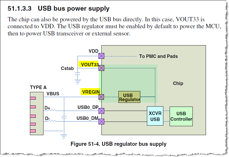

About the VREGIN and VOUT33, here you can refer:

Robin_Shen
All the Kinetis MCU with USB module has the USB regulator embedded.
