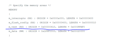

and this is memory configuration for my application:
HEAP_SIZE = DEFINED(__heap_size__) ? __heap_size__ : 0x0;
STACK_SIZE = DEFINED(__stack_size__) ? __stack_size__ : 0x0400;
M_VECTOR_RAM_SIZE = DEFINED(__ram_vector_table__) ? 0x0400 : 0x0;
/* Specify the memory areas */
MEMORY
m_interrupts (RX) : ORIGIN = 0x0000a000, LENGTH = 0x00000400
m_flash_config (RX) : ORIGIN = 0x0000a400, LENGTH = 0x00000010
m_text (RX) : ORIGIN = 0x0000a410, LENGTH = 0x000FFBF0
m_data (RW) : ORIGIN = 0x1FFF0000, LENGTH = 0x00020000

nxf56274
You do not change this line. The application and 'm_falsh_config' address should not begin with 0x410.
The link I gave you has the picture related with the link file. You can refer it.

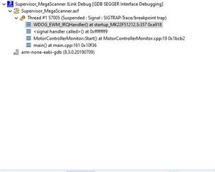

LArmstrong1985
I thought it was a UART problem, instead the application starts but after a few instructions I get the following error
I try to move/comment some instructions but simply the problem shifts.
The application has been tested and works correctly at location 0x0000 therefore with standard startup script and linker file automatically generated. I suspect the problem lies with the startup scripts.
What can i check? The only difference than the examples is that mine is a c ++ project with mixed code c / c ++. Are startup files always okay?

LArmstrong1985
I managed to solve, following this guide of the mythical @ErichStyger (Erich Styger) who uses another technique
Linking Bootloader Applications with Eclipse and FreeMarker Scripts | MCU on Eclipse
Thank a lot @ErichStyger!
