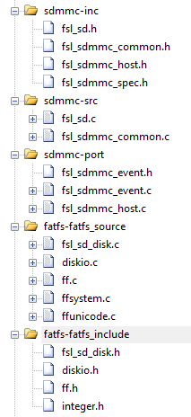

The bootloader uses SDHC and fafts file system. So we should add files to support it.
                  Figure 2.The support file

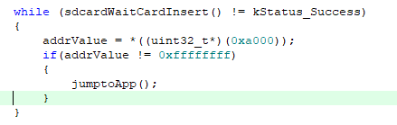

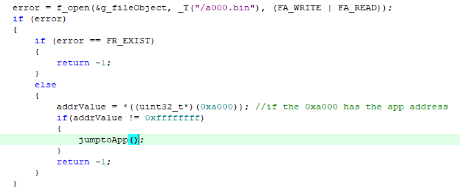

In main code, the program will wait until the card has inserted. Then it will find the file named “a000.bin” in sd card to update the application. If the file do not exist, the board will directly execute the application. If there is no application, the program will end.
The following code shows how the program wait for inserting sd card. It will also check if the address has the application’s address.
                     Figure 3.The code -- wait for inserting card
The following code shows how the program opens the binary file. If sd card doesn’t have the file, the program will go to the application.
Figure 4.Open the binary file

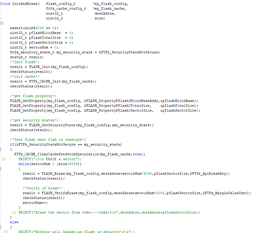

If the program opens the file normally, the update will begin. It will erase 200k’s space from 0xa000. You can adjust it according to your project.
Now I will explain update’s method in detail. Our data is written to the buffer called “rBUff”. The buffer size is 4K. Before write data to it, it is cleared.
 Please note that when we erase or program the flash, we should disable all interrupts and when the operations finish we should enable the interrupts.
 The file size will decide which way to write the data to flash.
 1If the size < 4k ,we just read the file’s data to buffer and judge if its size aligned with 8 byte. If not , we increase the size of “readSize” to read more data in our data buffer called “rBuffer”. The more data we read is just 0.
   2If the size > 4K, we use “remainSize” to record how much data is left. We read 4k each time until its size is smaller than 4k and then repeat step 1. When finish the operation at a  time, we should clear the buffer and increase the sector numer to prepare the next transmission.
Figure 5.Write flash operation code
The way to clear the space is shown in the figure. It will initialize the flash and erase the given size from the given address.  “SectorNum” is used to show which sector to erase.

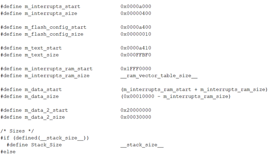

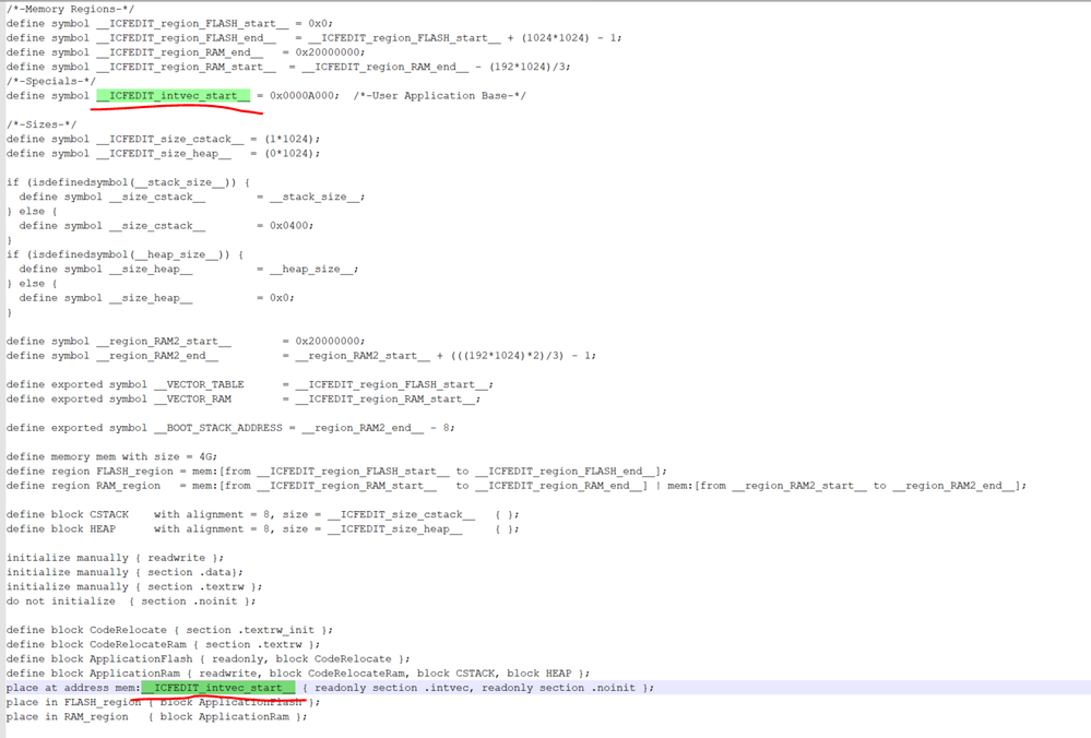

3Memory relocation
The FRDMK64 has the 1M flash, from 0x00000000 to 0x00100000.As shown in figure 10,we use the 0xa000 as the application’s start address.
           Figure 10.The memory map
Now, I will show you how to modify the link file for user application in different IDE.
In IAR
                                   Figure 11.IAR’s ICF
In MDK
Figure 12.MDK’s SCF

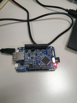

4Run the demo
1) Download the bootloader first.
2) Prepare a user application program. We use the “led blinky” as an example.
3) Modify the Link file.

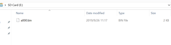

4) Generate the binary file with your IDE, please name it as “a000.bin”.
5) Put it into the sd card like figure 5.
Figure 14.SD card’s content
6) Insert the card. And power on. Wait for a moment, the application will execute automatically.

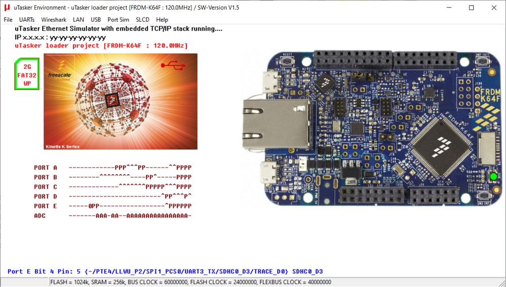

There is also an SD card boot loader for the FRDM-K64F which works on SDHC or on SPI - also works on any other Kinetis part - at http://www.utasker.com/kinetis/FRDM-K64F.html
It is fully documented at Serial Loader: http://www.utasker.com/docs/uTasker/uTaskerSerialLoader.pdf and can be mixed with other loading methods.
The SD loader can use wild card file matching, and encyryption (including AES256) for IP protection, with SD card clean-up after the loading has completed.
It can be built for any Kinetis part with KDS, MCUXpresso, IAR, Keil, S32, Rowely Crossworks, Green Hills, Atollic, CooCox, GCC make and fully simulated (including Kinetis device and SD card) in Visual Studio.
The SD card loader size is 14k in size (with FAT16, FAT32 and LFN support) and so is more code efficient (application start address can be at 0x4000 - saving 32k over the demo).
It also allows the same operation on memory stick (can be used in parallel to SD card) via USB-host interface: Featured video: https://www.youtube.com/watch?v=VJ7YveF4_8g&list=PLWKlVb_MqDQFZAulrUywU30v869JBYi9Q&index=26 which increases the loader size to 26k (link address 0x7000)
It is available as free open source and has been used in many industrial based Kinetis products since 2011 and is thus fully mature and proven.

Simulated FRDM-K64F SD card and Memory stick loader in operation in Visual Studio:
