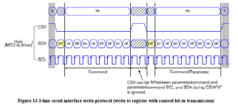

I'm trying to get a new LCD screen going but i need to send 9 bit spi packets (see image). On the K70, I tried to change the framesize to 9 but the LCD still does not communicate. I don't want to write a bit-bang SPI driver, so can the framesize be set to 9?  I send the data as a uint16, but im not sure if the SPI is sending the extra zeros.  I might need to hook up a scope.
See code below. I want to make sure this is the proper way to send 9 bit packets.

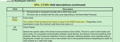

   About the K70 SPI frame size,  it can support programmable serial frame size: 4 to 16 bits.
  You can configure it in this register:
So, please check your code, and debug the code, check the register, whether the above FMSZ is configured to 8? Then the real number of bits per frame should be 9.
You also can test the SPI bus data which is sent out from K70, whether it is really 9 bits.
Wish it helps you!
