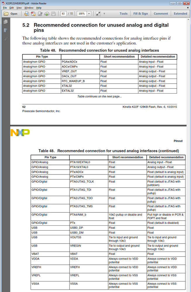

About the usused pins, please refer the "5.2 Recommended connection for unused analog and digital pins" in K22P121M100SF9.
The K22 series is recommended for the new design. You can have a look at MK22FN128VLH10, it is cost effective.

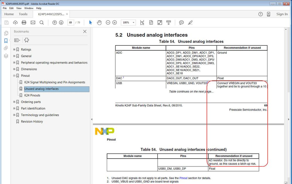

Hi Robin,
I am not clear with those two pins, can you please  help with this?:
VOUT33 , Tie to input, which input?
VREGIN, Tie to output, which output?
Senad
4,131件の閲覧回数
Robin_Shen
Hi Senad,
The input is VREGIN, and the output is VOUT33.
This means connect VREGIN and VOUT33 together and tie them to ground through a 10k resistor.
Robin
