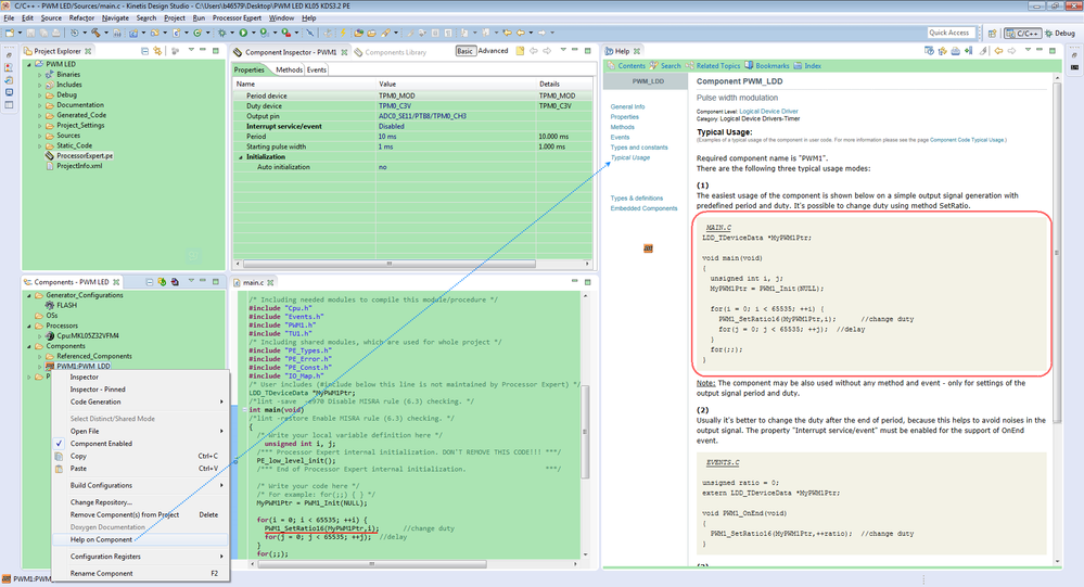

Please anybody tell me how to control the brightness of an led in FRDM-KL05Z using pwm component in the processor expert. Reply with code...

Hi Yadhukrishnan,
Please refer the Typical Usage of Component PWM_LDD.
Then you can see the brightness of Red LED changes.
Robin
