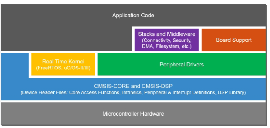

KSDK Structure Diagram
KSDK Features
ARM® and DSP standard libraries, and CMSIS-compliant device header files which provide direct access to the peripheral registers
Open-source peripheral drivers
Open-source RTOS wrapper driver
Real time operation systems (RTOS) including FreeRTOS OS, μC/OS-II, and μC/OS-III
Stacks and middleware in source or object formats including:
CMSIS-DSP -  a suite of common signal processing functions
FatFs - a FatFile System for small embedded systems
mmCAU - Memory-Mapped Cryptographic Acceleration Unit
SDMMC - software component supporting SD Cards and eMMC
DMA Manager - software component used for managing on-chip DMA channel resources
mbedTLS and WolfSSL - cryptographic SSL/TLS libraries
lwIP and USB Stack - a light-weight TCP/IP stack

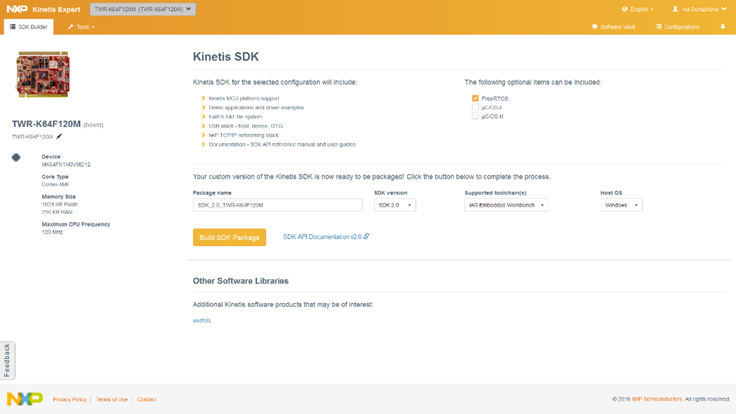

Installation of KSDK -> KEX Tool (smaller download & sizes)
KEX Tool -> pin muxing selection & generation, clock configuration, low power estimation

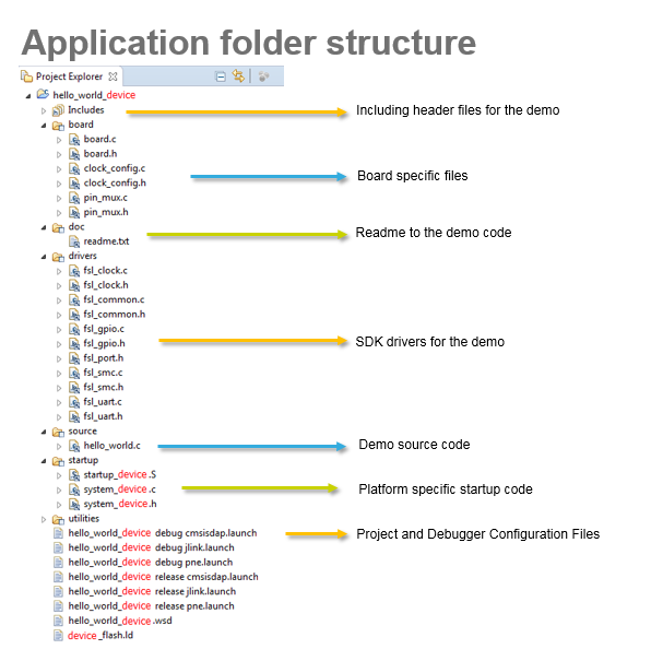

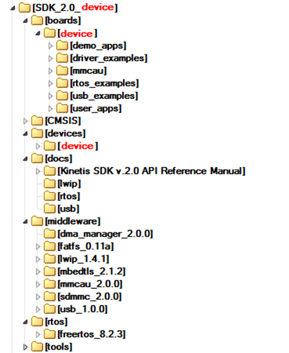

Simplified folder structure

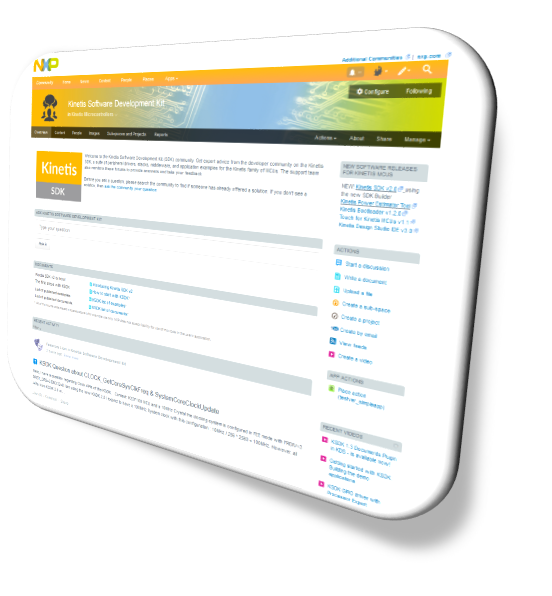

KSDK Community
https://community.freescale.com/community/kinetis/kinetis-software-development-kit
