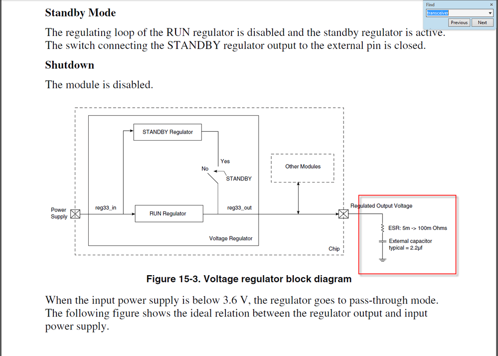

Everything is fine, except lacking a capacitor on VOUT33, please kindly refer to the following for details.

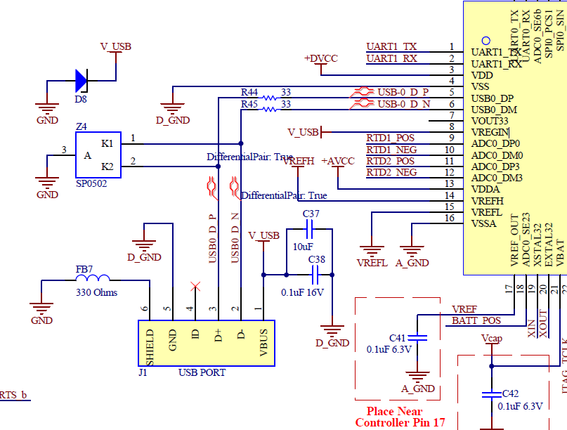

If you didn't modify the CDC demo, there might be issue in hardware, would you please share some snapshots of the schematics? Thanks for your patience!

codyrigney
Hi Kan,
I appreciate the depth at which you are helping me.  I believe the snapshot below should have all the relevant information.  If you need to see another part please let me know.  Thank you!
(Voltage goes to power regulator and does work).

Kan_Li
Hi Cody,

codyrigney
It was a design problem.  Thank you!
