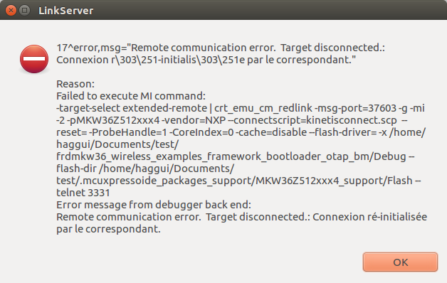

hagguisouhail
Hello Miguel,
I integrated the new SDK into our project, however I noticed that I am not able any more to debug the project. Notice that I am using Jlink from Segger. Even when trying with the LPC-Link v2 on which I programed the CMSIS (with lpcscrypt), I fail to flash the program on the kw36 mcu. Can you help me with this issue please.
Best raegrds,
Souhail

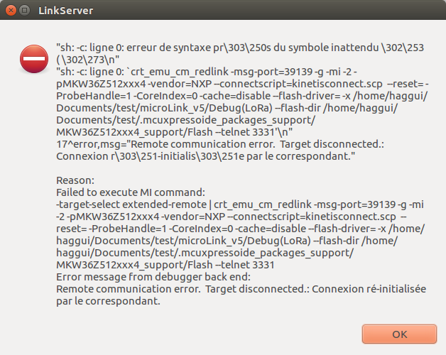

hagguisouhail
Hi Miguel,
Allow me just to give you an overview to be more clear. We are working on a project that is based on the OTAP client example. Thus we have designed a new hardware based on mcu kw36 and we intend to program it via SWD JLINK or CMSIS-DAP. The first issue was the m_text memory exeecds the P-Flash section and you resolved that by adding the D-Flash section, with this modification we were able to program the kw36 only with the CMSIS-DAP interface of the LPC-Link v2, the Jlink didn't work with this modification and we were waiting for Segger to update their Jink driver. After that we have issue with OTA on two different memory bank, and you came up with one flash memory driver FTFE_2K_PD.cfx with the new SDK. I installed the new mcuxpresso 10.03 as you told me , before, I got the new software version of the LPC-Link v2 (Probe Firmware: LPC-LINK2 CMSIS-DAP V5.224) and I tried to flash the bootloader binary and otap application onto the kw36, Nevertheless I got an error and I am not able to resolve it.
I joined the error message that I got and here after you will find the consol log of the mcuxpresso.
Can you please verify with me this issue.

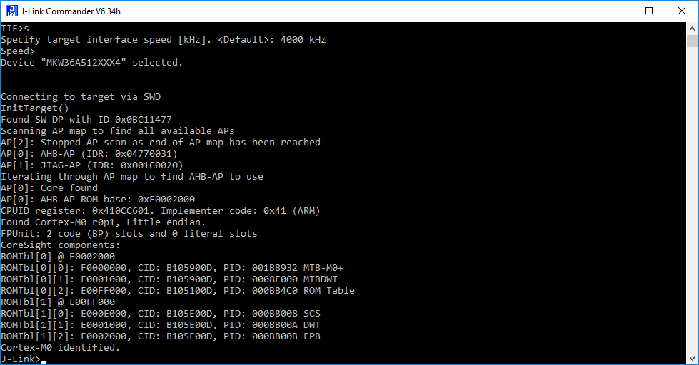

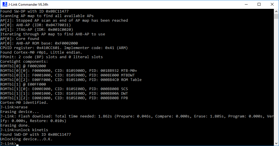

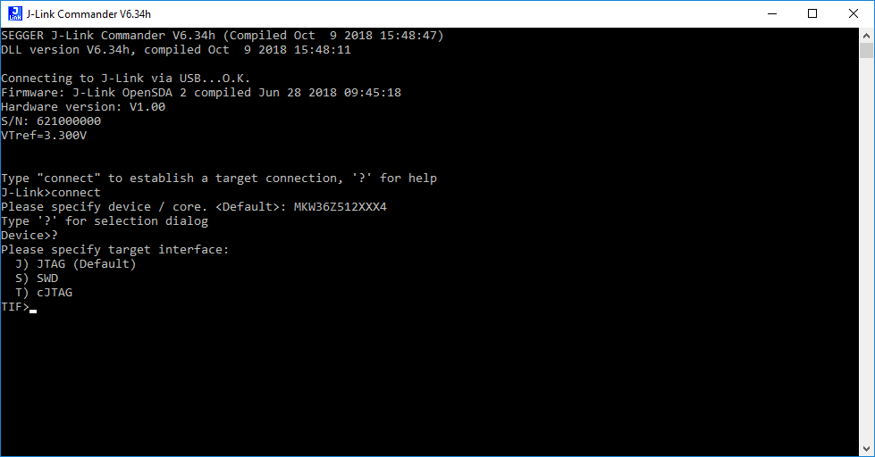

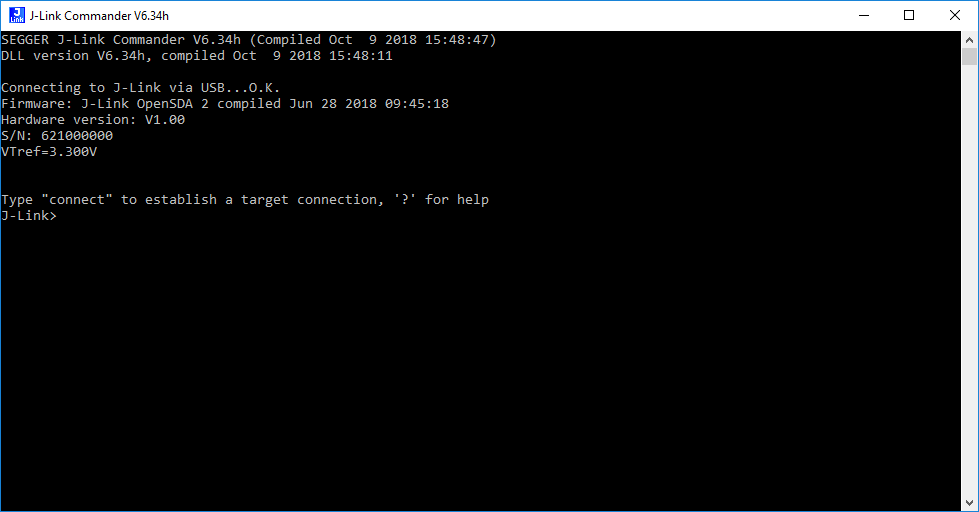

EdgarLomeli
Hi Haggui
Did you try to perform a mass erase and unlock the chip before to program the OTAP bootloader?
Here are the steps to do it:
1-Change the OpenSDA firmware to J-Link version. Follow the steps in this post: FRDM-KW36: Update OpenSDA Firmware.
2-Open the J-Link Commander console. It is default located at C:\Program Files (x86)\SEGGER\<JLink_version>\JLink.exe
3-Type the command "connect". Then type "?" to select the device (MKW36Z512XXX4).
4-Select the SWD interface. Type "s". Then press "enter" again.
5-Type "erase" in the console. Then, type "unlock kinetis"

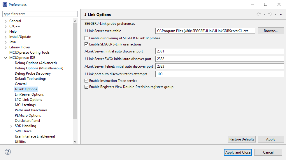

EdgarLomeli
Hello [email protected]‌,
There are the steps to update the J-Link drivers package in MCUXpresso IDE to handle the DFlash range address:
  1. Ensure that you have updated the OpenSDA firmware with the newest version. Go to the J-Link web site, scroll down and search for the J-Link OpenSDA - Board Specific Firmwares. Download the newest firmware for the FRDM-KW36. Also, download the beta version of the J-Link Software and Documentation Pack.
  2. Follow the steps described in this community post to update the OpenSDA firmware binary.
  3. Update to the newest version of MCUXpresso IDE.
  4. Open MCUXpresso, go to "Window -> Preferences". A new window will be shown. Go to "MCUXpresso IDE -> J-Link Options". Change the default JLinkGDBServerCL.exe path next to "J-Link Server executable text box", by the JLinkGDBServerCL.exe version included in the new beta pack that you have downloaded. The new path must be the following if you left the beta J-Link Software and Documentation Pack installation as default.pastedImage_2.png
  5. Try to program the device, and verify that the DFlash area is programmed or erased as you expect.
Please, tell us if this has solved your issue.
