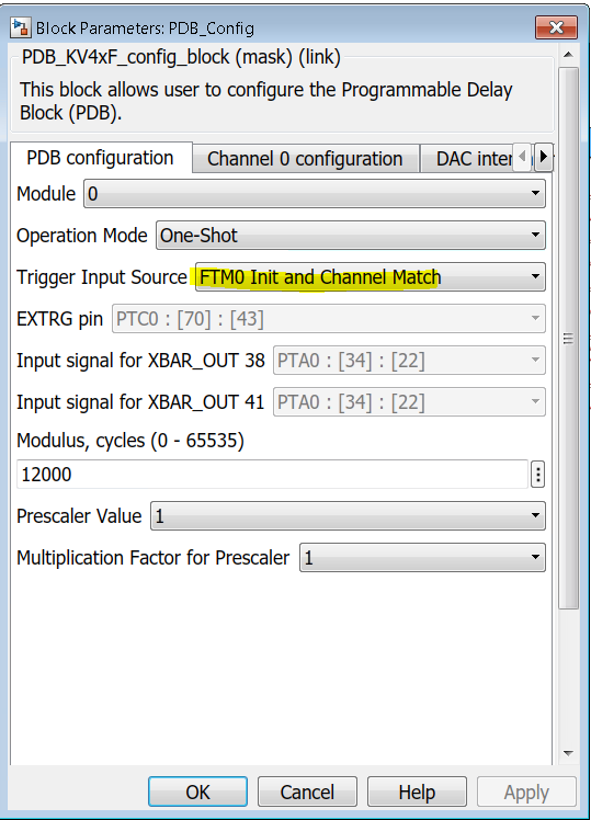

I have set the Initialization Trigger in the external Trigger tab of "FTM Three Phase Output", which should be exactly in the middle of PWM low side Signal.
In the PDB config block I have configured "FTM0 Init and Channel Match"
Modulus: 120MHz / 10kHz = 12000
I only have configured one Pre-Trigger in the Channel 0 configuration without any delay.
All configured samples are read in this Moment.

But If I activate the "Pre-Trigger 1 Enabled" Option all configured samples are read two times in one pwm cycle.
This leads to Problems because maybe the low side igt is not in conduction for the second measurement.

PreTrigger0 - ADCA: I_phA ; ADCB: I_phB with delay 0
PreTrigger1 - ADCA: U_dcb ; ADCB: I Temp with delay 1450 (which is not activated yet)
The ADC(in simultaneous mode) is triggered from the PDB0
scan mode: Triggered Parallel
