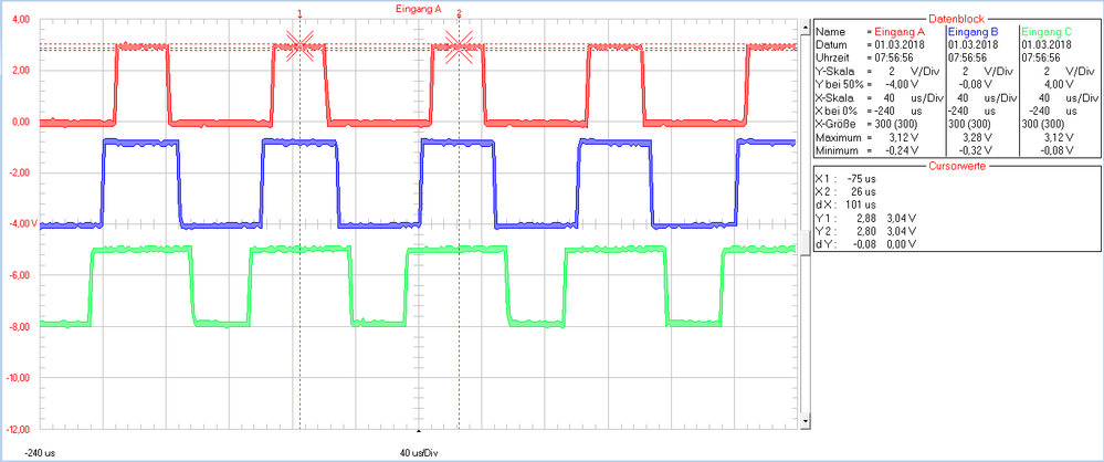

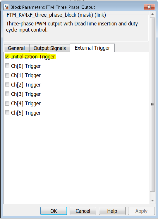

First of all the three PWM low side igbt signals:
I have set the Initialization Trigger in the external Trigger tab of "FTM Three Phase Output", which should be exactly in the middle of PWM low side Signal.

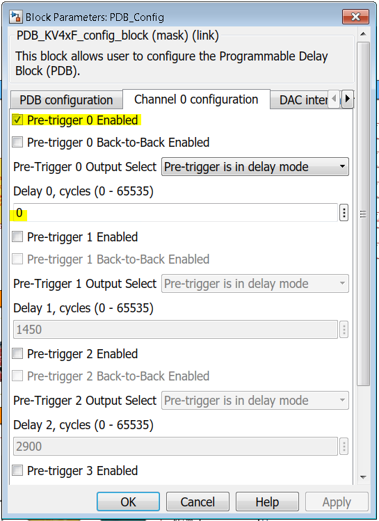

In the PDB config block I have configured "FTM0 Init and Channel Match"
Modulus: 120MHz / 10kHz = 12000
I only have configured one Pre-Trigger in the Channel 0 configuration without any delay.
All configured samples are read in this Moment.
My goal is now to seperate the adc reading.
But If I activate the "Pre-Trigger 1 Enabled" Option all configured samples are read two times in one pwm cycle.
This leads to Problems because maybe the low side igt is not in conduction for the second measurement.
It should be for example:
PreTrigger0 - ADCA: I_phA ; ADCB: I_phB with delay 0
PreTrigger1 - ADCA: U_dcb ; ADCB: I Temp with delay 1450 (which is not activated yet)

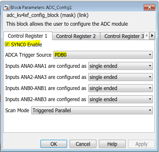

The ADC(in simultaneous mode) is triggered from the PDB0
scan mode: Triggered Parallel
maybe the scan mode is not suitable for my Problem ?

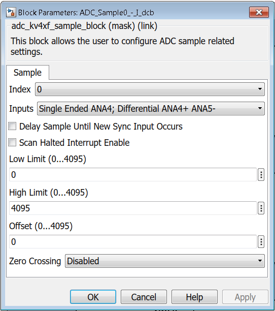

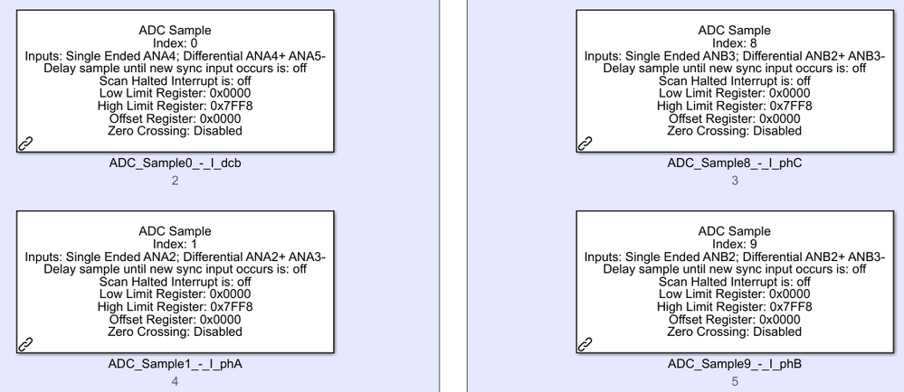

The ADC samples look like this:
One of the ADC_Sample Blocks:
Is it correct that I set the bit0/bit1 and bit8/bit9 for the ADC_SCTRL Register with the "Delay Sample Until New Input Sync Input Occurs" option ?
Or how I have to set bit0/bit1 and bit8/bit9 for the ADC_SCTRL Register ?

xiangjun_rong
Hi, Leon,
From the PE menu, i think if you check the "Delay Sample Until New Sync Input Occurs", the PE will generate the code to set the corresponding bits in ADC_SCTRL register, but I never have a try. You can check the ADC_SCTRL register in debugger if the bits are set or not  after PE has initialized ADC.
I think you can write the ADC_SCTRL Register directly for example with the code:

Now I had a try but it doesn't work like you expected.
If I check the "Delay Sample until new Sync Input Occurs" Option in every Sample Block then the code doesn't work successfull and no ADC on End occurs.
I also tried only to activate this Option in ADCA or ADCB samples, because with SYNC0 Input ADCB has the same Trigger Signal as ADCA:
only ADCA "Delay Sample until new Sync Input Occurs" on --> code does not run, no adc on end
only ADCB "Delay Sample until new Sync Input Occurs" on --> no accurate Phase currents
So if I uncheck this "Delay Sample until new Sync Input Occurs" everywhere, I also not have accurate Phase currents.
I think the ADC is triggered three times (Pre-Trigger0,1,2 is activated) and all samples are read with every Trigger.
If I deactivate pre-Trigger 1 and 2 the Phase currents Looks goot and only one adc on end occurs.
