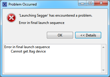

I have read the 2 pdfs (Kinetis Lock issue analysis and unlock way.pdf and Kinetis_unlock guide.pdf) and done everything that is said, directly from the IDE, from the J-Flash and from the cmd.
In the IDE a pop-up message appears, and I can't debug even the working MCU...

Device will be unsecured now.
Found SW-DP with ID 0x0BC11477
Scanning AP map to find all available APs
AP[2]: Stopped AP scan as end of AP map has been reached
AP[0]: AHB-AP (IDR: 0x04770031)
AP[1]: JTAG-AP (IDR: 0x001C0020)
Iterating through AP map to find AHB-AP to use
AP[0]: Skipped. Invalid implementer code read from CPUIDVal[31:24] = 0x00
AP[1]: Skipped. Not an AHB-AP
InitTarget()
Protection bytes in flash at addr. 0x400 - 0x40F indicate that readout protectio
n is set.
For debugger connection the device needs to be unsecured.
Note: Unsecuring will trigger a mass erase of the internal flash.
Executing default behavior previously saved in the registry.
****** Error: Could not find core in Coresight setup
InitTarget()
n is set.
InitTarget()
n is set.
Cannot connect to target.
Script processing completed.
C:\Program Files (x86)\SEGGER\JLink_V632d>‍‍‍‍‍‍‍‍‍‍‍‍‍‍‍‍‍‍‍‍‍‍‍‍‍‍‍‍‍‍‍‍‍‍‍‍‍‍‍‍‍‍‍‍‍‍‍‍‍‍‍‍‍‍‍‍‍‍‍‍‍‍‍‍‍‍‍‍‍‍‍‍‍‍‍‍‍‍‍‍‍‍‍‍‍‍‍‍‍‍‍‍‍‍‍‍‍‍‍‍‍‍‍‍‍‍‍‍‍‍‍‍‍‍‍‍‍‍‍‍‍‍‍‍‍‍‍‍‍‍‍‍‍‍‍‍‍‍‍‍‍‍‍‍‍‍‍‍‍‍‍‍‍‍‍‍‍‍‍‍‍‍‍‍‍‍‍‍‍‍‍‍‍‍‍‍‍‍‍‍‍‍‍‍‍‍‍‍‍‍‍‍‍‍‍‍‍‍‍‍‍‍‍‍‍‍‍‍‍‍‍‍‍‍‍‍‍‍‍‍‍‍‍‍‍‍‍‍‍‍‍‍‍‍‍‍‍‍‍‍‍‍‍‍‍‍‍‍‍‍‍‍‍‍‍‍‍‍‍‍‍‍‍‍‍‍‍‍‍‍‍‍‍‍‍‍‍‍‍‍‍‍‍‍‍‍‍‍‍‍‍‍‍‍‍‍‍‍‍‍
I tried by pressing the reset button the whole time before powering on the MCU, then without the reset button pressed and connected to the reset of the OpenSDA...
As a test, I connected the ONLY MCU that is still working with the J-Flash and I could connect to the device successfully.
I have to be doing something wrong (in the PCB I guess) but I really don't know what or how to find it out... Smiley Sad
Anything else I could test? When powering up for the first time? or maybe solder some (5) wires instead of the whole IC to the PCB?
Many thanks!!!
