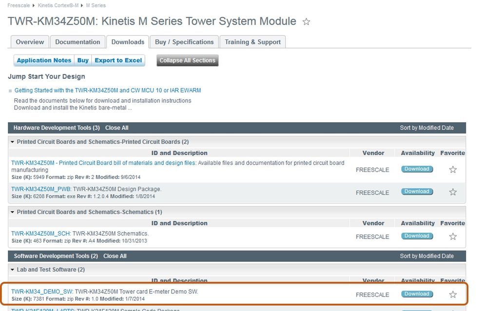

isaacavila
Hello Harish,
On TWR-KM34Z50MV3 main page (http://www.freescale.com/webapp/sps/site/prod_summary.jsp?code=TWR-KM34Z50M&lang_cd=) you can download a source code package (download section) called TWR-KM34_DEMO_SW.
After downloading, you need to install this packege and then import project _tower_lcd_test. (this project is located at: <installation_path>/build/<cw_10_5>/projects).
Note: Same package is also available for IAR IDE.
If you compile this project and run on your TWR board, you will see that LEDs are blinking as well as voltage level from potentiometer is displayed on LCD.
if you have any doubts please let me know it.
