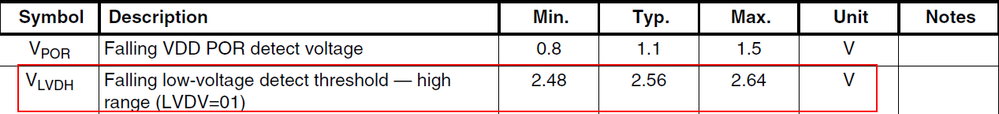

Then as noticed by Alice the voltage threshold with these settings is not exactly 3.1 V, but 3V for Low Voltage Warning and 2.56V for Low Voltage Detect.

Thanks Alice and Jorge.  I will try this.  Our chip runs at 3.3v.
Alice, the Datasheet 2.2.2 page looks same as what you posted.

Hello John,
What is your voltage of low voltage ? It is not only under 3.1 the low voltage can detected.
You can find information regard VLVDL and VLVDH on the K4 datasheet :
2.2.2 LVD and POR operating requirements ->
Please check the voltage of your chip .
