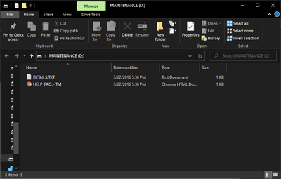

3. I bought couple of FRDM-KL26Z eval boards and they both were not working. Then i searched about this in the forum and found that they are non-programmed on both the K20 and KL26. So i followed the thread: https://community.nxp.com/t5/Kinetis-Microcontrollers/FRDM-KL26Z-DOA/m-p/1249153#M59937 programmed both K20 and KL26, but i can only brought the board up to a maintenance drive when i plus in the USB to the OpenSDA port. I am still having trouble to bring it to a working condition. Can you help to guide me to bring up these eval board? please show as detail as possible.

For the OpenSDA, do you have any idea how I resume the OpenSDA port? I won't be able to bring back the bootloader function, it popped up as the maintenance drive everytime i plug in the USB into the openSDA. Please advise.
Gilbert
17,670件の閲覧回数
jingpan
Hi @gsmgbl ,
Have you download DAPlink firmware?
Jing
17,659件の閲覧回数
gsmgbl
Hi Jing,
I tried those two binary files called "0244_k20dx_bl_0x8000.bin" and "k20dx_frdmkl26z_if_crc.bin", but my KL26 eval board can still shows up as a maintenance drive only.
From the thread, it reminds us to program the hello world into the eval board and i did this too, the board still shows up as maintenance, see below.
Please advise detail steps, as well as file location and link etc. Thanks!!
17,621件の閲覧回数
jingpan
Just drag and drop k20dx_frdmkl26z_if_crc.bin to the virtual disk. No other special steps.
Jing
17,609件の閲覧回数
gsmgbl
Hi Jing,
I followed your instruction and simply drag and drop into the drive, after that, it closed itself and popped up the same as the maintenance drive again. I tried a few times and it does the same. Is there any problem with the board? Do you have any other recommendation to help me troubleshoot on this. In fact, we bought two of this eval board and they are both the same. Please advise.
Thank you very much!!
17,595件の閲覧回数
jingpan
Hi @gsmgbl ,
1.Please measure the pin 1 voltage of SW2. It should be 3.3v.
2. If #1 is fine, please try drag and drop on other computer.
Jing
17,517件の閲覧回数
gsmgbl
Hi Jing,
Thanks for the help!
Unfortunately, it still doesn't work. I measured the voltage of SW2, it is confirmed 3.3V. After that i drag and drop the the file from my local drive to the board, then unplug and plug back the USB again, but it still shows up as maintenance drive.
Gilbert
17,513件の閲覧回数
jingpan
Hi @gsmgbl ,
Please try the jlink firmware. https://www.segger.com/downloads/jlink/OpenSDA_FRDM-KL26Z
If it can't work too. Please send me the DETAILS.TXT in MAINTANCE.
Jing
17,488件の閲覧回数
gsmgbl
Hi Jing,
Unfortunately, the board is still shows up as maintenance.
Please see the attached details.txt.
FYI, i first drag and drop your binary file in the maintenance drive, then i have this text file.
After that, i tried to program the binary file directly into the K20 through SWD, then the board won't boot up as maintenance anymore.
Again, greatly appreciated all your help and patience! Your support is impressive! Thank you!
17,482件の閲覧回数
jingpan
Hi @gsmgbl ,
This file looks fine. I'm really don't know why. Please try to drag and drop on the computer, win7 or even linux.
Jing
17,364件の閲覧回数
gsmgbl
Hi Jing,
Very unfortunate, no luck with your recommendation.
Is there any possible way to resolve this from NXP??
Please advise. Again, thank you very much for all your efforts!
17,317件の閲覧回数
jingpan
Hi @gsmgbl ,
Please contact the distributor you bought this board from.
Jing
