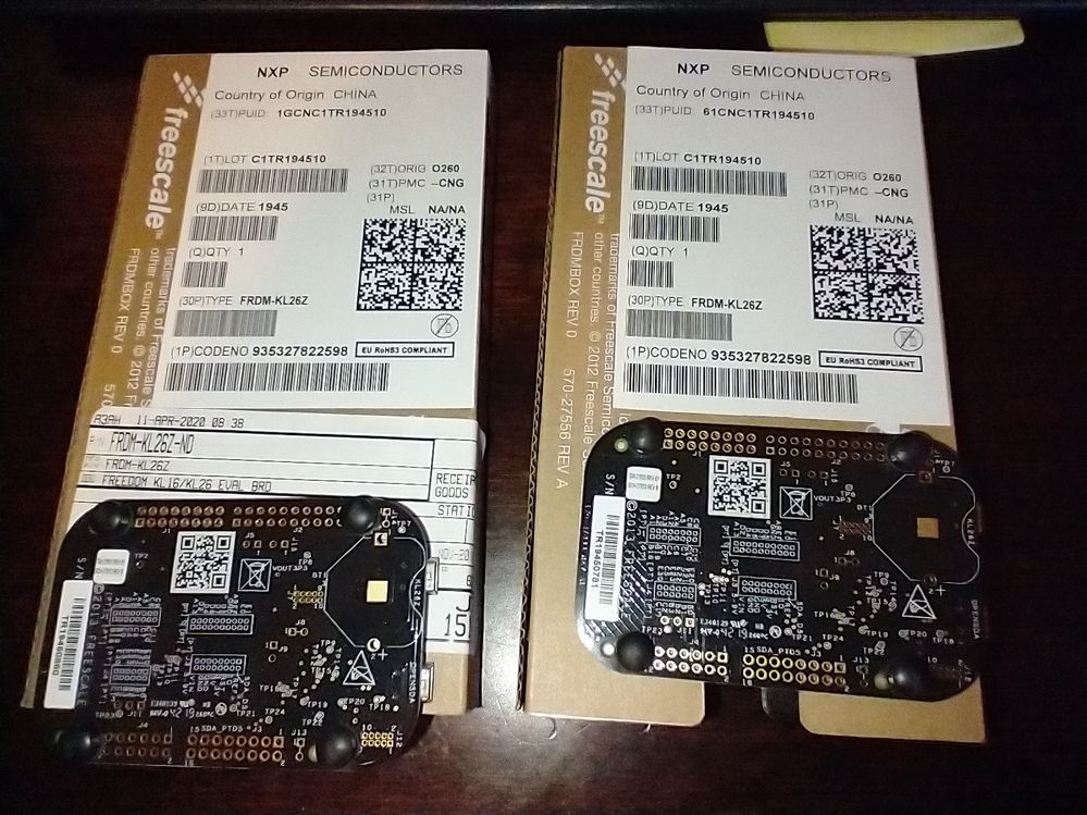

Got a FRDM-KL26Z from Digikey and it's dead on arrival. Connecting the device to power via USB reveals no activity. Documentation indicates that there's a demo onboard. No evidence of any such thing with this board. Connecting it to a Mac and running USB Prober reveals that there's no device connected to the Mac. No activity on the board when powered in any way. No MSD. No change when holding down reset.
Digikey was very kind to send a replacement. It's just as useless.
What's the deal?
Andre.

I just bought 2 of these from Digi-Key and they are DOA as well.  Glad I found this post so I know I'm not crazy.
 I don't think it's a Windows 10 issue, since the supposed demo doesn't run even when powered by a USB charger.  My guess is that both chips are unprogrammed.
EDIT: as requested here's a photo of what I got:

Frotz
I'm sorry you're having trouble. But I'm also relieved I'm not the only one!
You would have read the other posts in this thread by now and found that there's no way to get the K20 to reliably halt in order to reprogram it. I hope you can find some fix for it.
Incidentally, could you post a picture of the boards and the lot #'s like I did. I'd be interested to see if they're from the same lot/date.

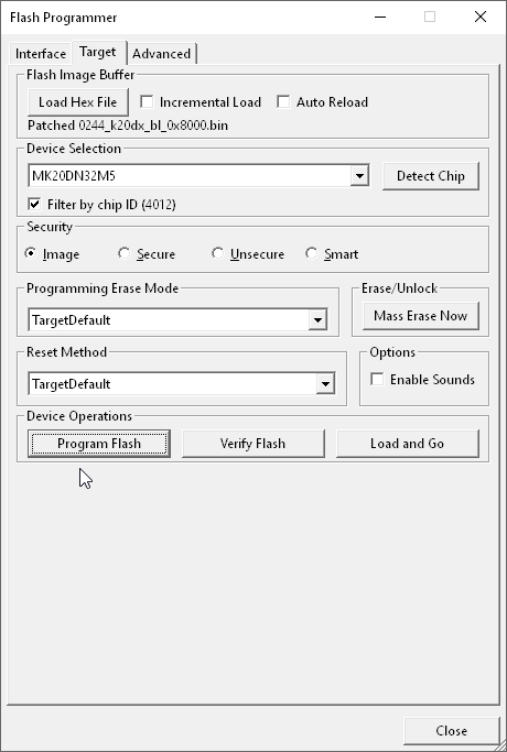

I was able to program the debugger chip MK20DN32M5 on my blank FRDM-KL26Z boards.
I used another board that I already had to program the new one.  It's a FRDM-KL25Z board, which I had converted to USBDM see: http://usbdm.sourceforge.net/USBDM_V4.12/html/index.html
I initially programmed the patched DAPLink and it seemed to work somewhat.  The MSD drive comes up with the name "MAINTENANCE", regardless of whether I hold down the reset button when plugging in to USB.
But I can't seem to get it to load USBDM.  USBDM instructions assume that the K20 is running openSDA v1 from PEmicro, so I would like to flash the K20 with the original openSDA v1.  Where can I find the binary to flash that?
I went to https://www.nxp.com/design/software/development-software/sensor-toolbox-sensor-development-ecosystem... which led me to PEmicro's site http://www.pemicro.com/opensda/
I downloaded Pemicro_OpenSDA_Debug_MSD_Update_Apps_2020_05_12.zip but it's not clear if any of the included binaries can be flashed directly to the K20.  They are mostly *.SDA files and a few *.bin files.

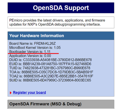

I update a old FRDM-KL26 from V109 to V111 just now.  A win7 is must. Win10 or Mac doesn't work.
1. Hold the reset button and connect the board on a win7 computer. You can see a new disk named bootloader.
2. Copy the BOOTUPDATEAPP_Pemicro_v111.sda to it. Then disconnect USB.
3. Connect USB again (needn't holding reset button), the disk appear. In the disk, there is a sda_info.htm. Open it, you can see a PEmicro webpage. It can tell you current openSDA version is 111.
4. You can leave the win7 computer now. You can copy debug probe application to the board by a win10 or a Mac.
So, the key is to find a win7 or XP. Some one said XP is better. I'm sorry for it.

I don't think you understand what we are trying to telling you.  The chips on the boards we got from Digi-Key are blank!  There is nothing programmed on the MK20 chip (or the target).  So how are we supposed to update the bootloader using a bootloader that isn't there?
I suggest you get one of these from Digi-Key to confirm.
Can I please get a copy of the original bootloader binary  P&E Micro v109 so I can flash it to the KL20 with an external flasher?  (or a newer bootloader which works on this board)
I said it was the MK20DN32M5 because that is how the USBDM programmer identified it (using chip ID). I guess it's possible they also put the wrong chip on these boards...
As you were able to re-program the K20 on the board, that's definitely a huge issue: all the boards I know and have with OpenSDA V1.x (and the KL26 is one) have a protected bootloader from P&E. I'm not able to erase or reprogram it. So this tells me that there must be a batch of boards produced incorrectly. So this is something NXP needs to fix (I assume they get produced and then shipped to DigiKey). I would recomend that you report back to DigiKey because they probably have a large batch of not working boards.
The P&E Bootloader image is imho not available anywhere. But you could flash that patched bootloader you mentioned above (https://github.com/ErichStyger/mcuoneclipse/tree/master/OpenSDA/OpenSDA%20V2.2/mbed%20DAPLink%20v244 from https://mcuoneclipse.com/2017/10/29/adding-a-delay-to-the-arm-daplink-bootloader/ ) and you have that way even a better bootloader on it compared to the original one.

p.s. My two boards show M20AGV 4N86B AALJG so they're MK20's on the outside. Are the MK20's on the inside?! Remember that I got almost nowhere with a J-Link...
