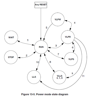

I am evaluating the KL26 to see if this MCU fits my design, so I am trying some demo project on the FRDM-KL26Z eval board. I am trying to develop some power saving function under the FreeRTOS and since i am planning to wake up the MCU by a few pins from port C, i have to use VLPW mode. Here are my problems and questions:
1. Power mode switch demo: For the VLPW, it cannot switch from RUN directly based on the power mode state diagram, see below. So the transition is RUN -> VLPR -> VLPW.
I am confused with the demo project because it didn't show this transition. The demo project shows the following:

I don't see any transition to the VLPR, then VLPW. Plus i don't see the current consumption down to the specified level, so I am wondering if the demo is missing something in the VLPW power saving mode.

My operation is same as you, first manually step into VLPR and measure, than step into VLPW measure. The current drop from 1.38mA to 0.48mA. In run mode, the current is 9mA.
After you download the test code, you should disconnect SWD if you do not use on board openSDA.
Jing

In order to change from Run mode to VLPW mode, I have to manually change from RUN -> VLPR, then manually change from VLPR -> VLPW again. But i don't see the power consumption difference when i measured on my board, so i am confused and wondering if there is anything missing in the project. Please advise. Thanks!
