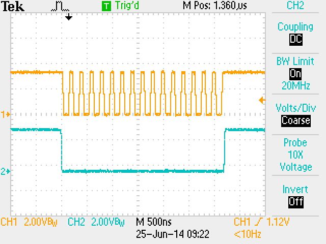

I am using codewrrior 10.5. and  MKL05Z32VLF4 uc. I am trying to read a register value, the value is not coming proper. The similar code is working fine with K20 board. The expected value from the sensor is 0xB1 (1011 0001) but the value coming is 0x58 (1011 000) Clearly I am missing he last bit. But I don't know how to resolve this issue.
The following image is of SPI_CLK and SPI_SS

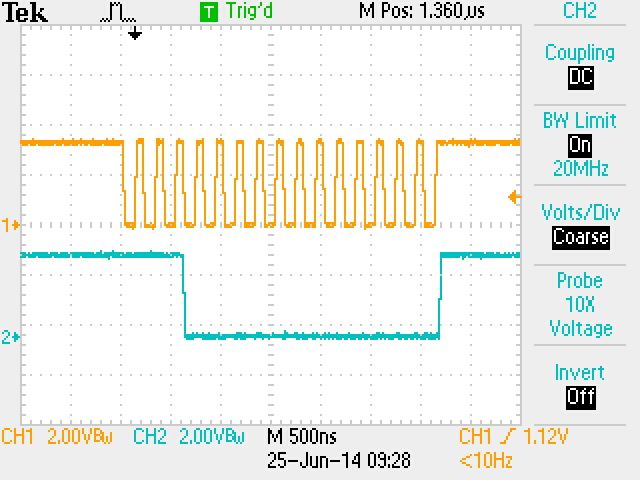

The following image is of SPI_CLK and SPI_MOSI Data being send is 0xE0(read + address) and 0x00 (dummy for receiving data)

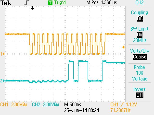

The following image is of SPI_CLK and SPI_MISO the expected value is 0xB1(1011 0001) but in terminal I am getting 0x58(1011 000)

You have programmed the clock phase incorrectly.
Notice that when your SPI master sends data the data changes on the rising edge of the clock signal.
When your SPI slave device responds with data it is changing the data on the falling edge of the clock.
This means that your SPI master will be reading the slave's data when its clock goes low, which is just 'before' the slave actually drives the new data bit onto the line. The result is that the master is reading one bit too early and the bit data is shifted in the bytes, with the final bit missing.
When using SPI always check the mode that the slave works in from its data sheet and then match the SPI master's settings to it [although some peripherals can match themselves to the setting - SPI flash devices typically can].

What I see from your original code is that the SPI configuration is set up for
  /* SPI0_C1: SPIE=0,SPE=0,SPTIE=0,MSTR=1,CPOL=1,CPHA=0,SSOE=1,LSBFE=0 */
  SPI0_C1 = (SPI_C1_MSTR_MASK | SPI_C1_CPOL_MASK | SPI_C1_SSOE_MASK); /* Set configuration register */
This is clock phase 0 and clock polarity 1.
There are 4 possibilities for the CPHA and CPOL combination (00, 01, 10 and 11).
Usually the data sheet for the slave device will specify the correct setting but I think that you may need phase 1 and polarity 0 instead.
I would simply overwrite the line that PE generates with the setting and even test all 4 possibilities so that you can see how each looks and also prove which one works correctly.
If you prefer to allow PE to set the bits for you you can still do it afterwards but with the knowledge of what the output should be in case of PE difficulties.

Your device samples on the rising edge and shifts data out on the falling edge. The timing looks like CPOL = '1' and CPHA = '1'.
If you are reading 0x00 it may be that the slave device is not understanding the command that you are sending and so really sending 0x00 back (check the bus again with the oscilloscope). Notice that originally also the timing was wrong for the slave device so it may have also been understanding your transmitted 0xc0 as 0xc1, or 0xe0 and now undestands it as 0xc0 - which could make a difference to its behaviour.

  MISO diagram: from the diagram, we can read back the data should
  be 0xb1 if you read the data on the rising edge, maybe you read
  data on the falling edge to cause the read back is 0x58. "

here At least I managed to get continuous 16 bit clk cycle. I am wondering why the device is not responding the MOSI signal is identical to the earlier signal which I posted for K20 board.
Then I removed the SS pin and left it floating, sometimes the value showed up i.e
SCL-MISO
in this case the value was not being displayed in the terminal window. may be SPIO_D is capturing 16 bit data and since it is an 8 bit register so the 0x00 value is only being stored in it and 0xB1 is getting discarded.
Then I grounded the SS pin and I got the following waveform
SCL-MISO
in this case , in the terminal window 0xB1 is being received.
But the above 2 were the wrong methods. I am wondering why isn't the value being displayed with the correct way. Anyways what are your further suggestion for making it work? Thanks
