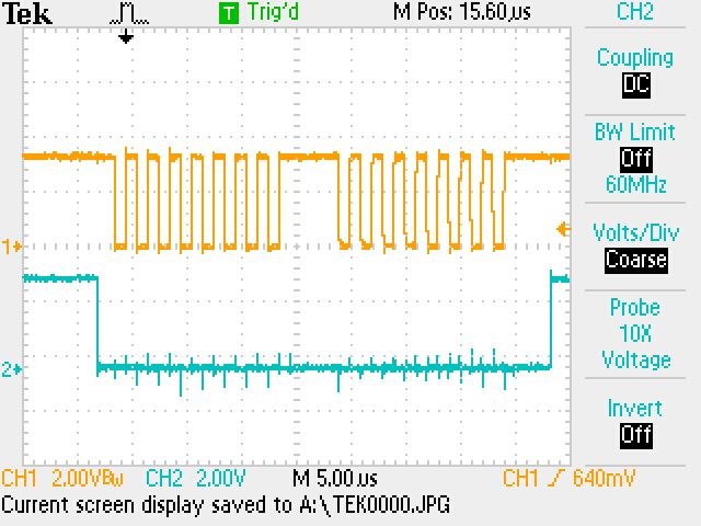

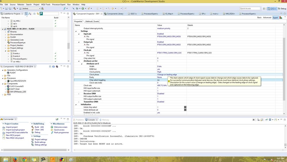

I am using codewrrior 10.5. and  MKL05Z32VLF4 uc. I am trying to read a register value, the value is not coming proper. The similar code is working fine with K20 board. The expected value from the sensor is 0xB1 (1011 0001) but the value coming is 0x58 (1011 000) Clearly I am missing he last bit. But I don't know how to resolve this issue.

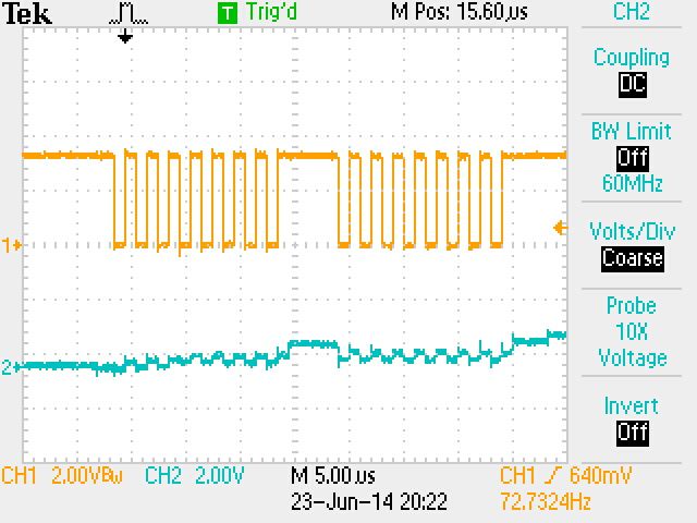

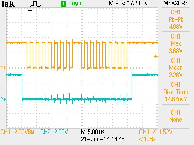

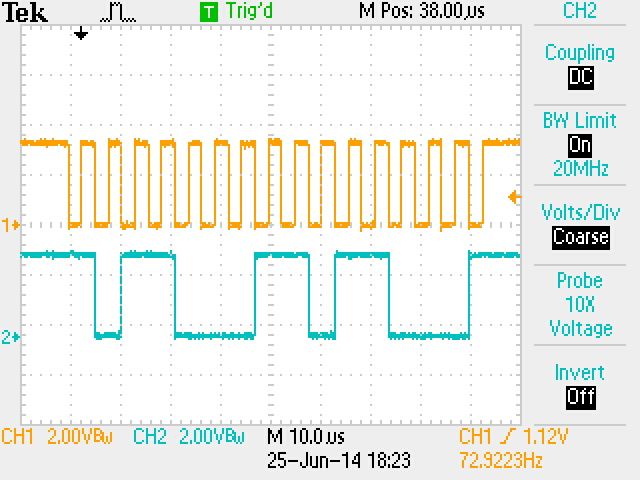

The following image is of SPI_CLK and SPI_SS
The following image is of SPI_CLK and SPI_MOSI Data being send is 0xE0(read + address) and 0x00 (dummy for receiving data)
The following image is of SPI_CLK and SPI_MISO the expected value is 0xB1(1011 0001) but in terminal I am getting 0x58(1011 000)

Hi Amit
You have programmed the clock phase incorrectly.
Notice that when your SPI master sends data the data changes on the rising edge of the clock signal.
When your SPI slave device responds with data it is changing the data on the falling edge of the clock.
This means that your SPI master will be reading the slave's data when its clock goes low, which is just 'before' the slave actually drives the new data bit onto the line. The result is that the master is reading one bit too early and the bit data is shifted in the bytes, with the final bit missing.
When using SPI always check the mode that the slave works in from its data sheet and then match the SPI master's settings to it [although some peripherals can match themselves to the setting - SPI flash devices typically can].

Hi Mark

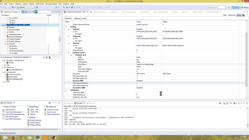

Thanks a lot for the reply. I tried changing the phase from capture on leading edge to change on leading edge. But in that condition it is giving 0x00 as output.
by the following setting I am getting 0x58 as output
If I change the phase, Chip select toggling is also changed to NO. and I am getting 0x00 as output.
How can I change data receive on falling edge?

What I see from your original code is that the SPI configuration is set up for
  /* SPI0_C1: SPIE=0,SPE=0,SPTIE=0,MSTR=1,CPOL=1,CPHA=0,SSOE=1,LSBFE=0 */
  SPI0_C1 = (SPI_C1_MSTR_MASK | SPI_C1_CPOL_MASK | SPI_C1_SSOE_MASK); /* Set configuration register */
This is clock phase 0 and clock polarity 1.
There are 4 possibilities for the CPHA and CPOL combination (00, 01, 10 and 11).
Usually the data sheet for the slave device will specify the correct setting but I think that you may need phase 1 and polarity 0 instead.
I would simply overwrite the line that PE generates with the setting and even test all 4 possibilities so that you can see how each looks and also prove which one works correctly.
If you prefer to allow PE to set the bits for you you can still do it afterwards but with the knowledge of what the output should be in case of PE difficulties.

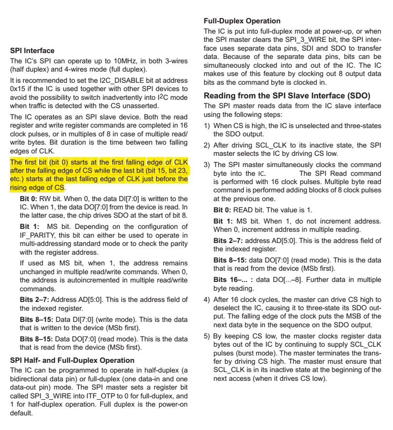

According to the datasheet,
following is the timing diagram
and the SPI configuration details

Your device samples on the rising edge and shifts data out on the falling edge. The timing looks like CPOL = '1' and CPHA = '1'.
If you are reading 0x00 it may be that the slave device is not understanding the command that you are sending and so really sending 0x00 back (check the bus again with the oscilloscope). Notice that originally also the timing was wrong for the slave device so it may have also been understanding your transmitted 0xc0 as 0xc1, or 0xe0 and now undestands it as 0xc0 - which could make a difference to its behaviour.

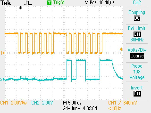

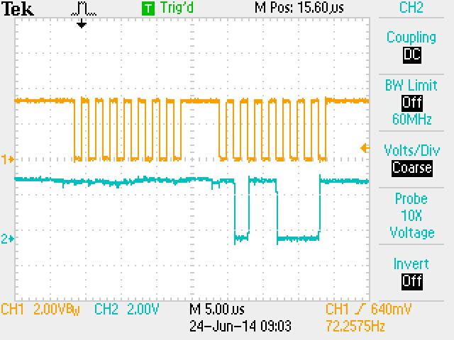

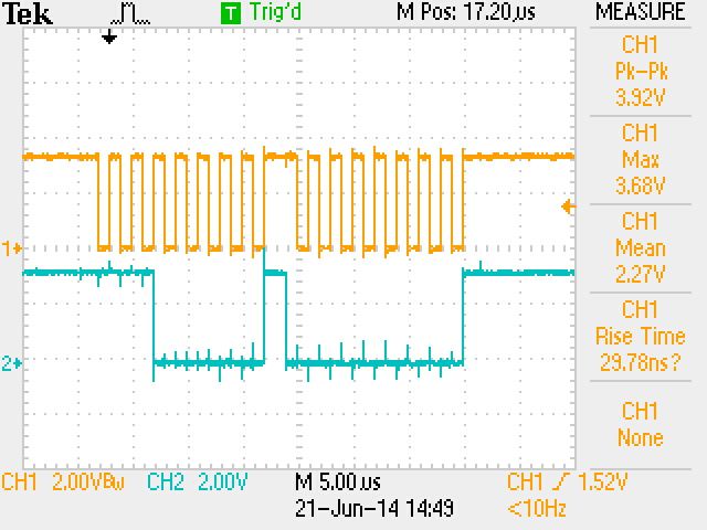

with CPOL = 1, CPHA = 1, following waveforms i got
SCL- SS
SCL-MOSI
SCL-MISO

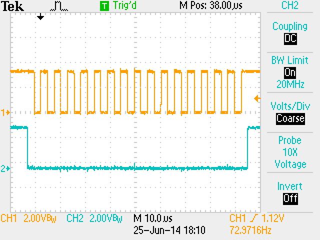

I am wondering can there be an issue of slave select ? as in the 1st fig. the SCL-SS both are not triggering simultaneously. and I used GPIO as ss because I needed 16 bit uninterrupted clk. If I use slave select pin from the component configuration , then after 8 bit there is a break in SS and hence no data is being received.

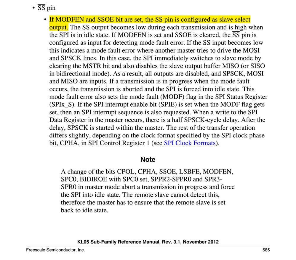

After this I tried manually triggering SS pin, once toggled the SS pin (PTA19)  and put it to low logic and the value was coming as 0xB1 which is the required value I did it with 2 registers reading instead of single register reading then it was giving 0xB1 as a constant value for both registers (utter failure). This device worked fine with K20 board. The major diff. was that in K20 I am getting a continuous 16 bit clock in KL05, there is a slight break after 8bit and that's why it is creating this problem. Is there any way to reduce the gap b/w both the clock pulses? If I could do that , I hope my device will start working perfectly.

Thanks for the above code. I tried that code , on probing I got the same waveform. I got response from the device support team with respect to the 3 waveforms which I posted initially in this thread. They said:-
"From the diagram you attached, you may mis-configurated  the SPI
   interface:
  MOSI diagram: according to SPI timing diagram in
  datasheet, it should be latch data on rising edge of SCLK , but
  from your diagram, it changed the state of MOSI when SCLK rising
  edge.
  MISO diagram: from the diagram, we can read back the data should
  be 0xb1 if you read the data on the rising edge, maybe you read
  data on the falling edge to cause the read back is 0x58. "
Now what Do you suggest me to do?
I am getting values (0x58) only when CPOL =1 and CPHA =0. In rest all the configuration I am getting 0x00;

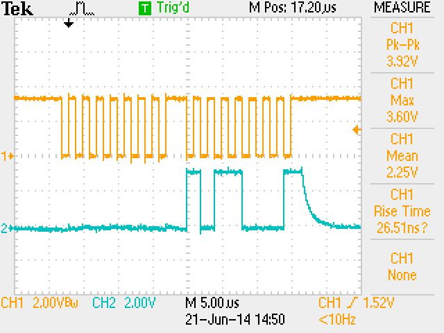

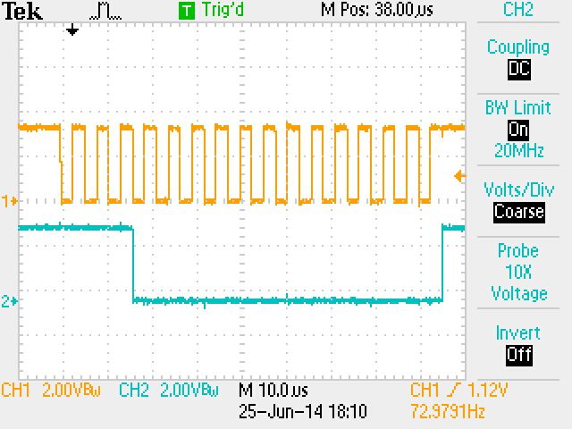

The output waveform from K20 board is :
                                                            SCL-SS
                                                            SCL-MOSI --> 0xE000 (E0-> Read WHO AM I, 00--> Dummy byte for receiving)
                                                       SCL-MISO --> 0xB1
Kind Regards
Amit Kumar
10,648 Views
mjbcswitzerland
Specialist V
Amit
The K20 code uses CPOL and CPHA = '1' and the waveform confirms that the clocks and bits retunred form the SPI slave are matching in both cases.
This means that I would expect you to read 0x00 (dummy) - 0xb1 in the final case.

I did the following changes in my code for KL05 uc,
CPOL, CPHA = 1
B.R = 187Khz i.e SPI0_BR = SPI_BR_SPPR(0x07) | SPI_BR_SPR(0x03) ;
I modified the read code

SCL-SS
SCL-MOSI
SS-MISO
here At least I managed to get continuous 16 bit clk cycle. I am wondering why the device is not responding the MOSI signal is identical to the earlier signal which I posted for K20 board.
Then I removed the SS pin and left it floating, sometimes the value showed up i.e
SCL-MISO
in this case the value was not being displayed in the terminal window. may be SPIO_D is capturing 16 bit data and since it is an 8 bit register so the 0x00 value is only being stored in it and 0xB1 is getting discarded.
Then I grounded the SS pin and I got the following waveform
SCL-MISO
in this case , in the terminal window 0xB1 is being received.
But the above 2 were the wrong methods. I am wondering why isn't the value being displayed with the correct way. Anyways what are your further suggestion for making it work? Thanks

I think may be there is some issue in ss configuration. as in above waveforms if you observe KL05 (16 bit continuous clock) and K20 working waveforms both have identical waveform for SS and MOSI . I Tested with same frequency and it was identical. but I didn't get the MISO waveform back for KL05. When I leave SS pin floating then sometimes I am getting the waveform so these results concludes that the issue may be with SS. I went through the configuration and confirmed that MODFEN, SSOE = 1. What else can be done to make this working? I know it is a dumb ques but it makes me wonder if  has anybody had interfaced and tested KL05's SPI. coz I think we have covered and checked almost all the registers settings for SPI, and same device is working fine with K20 so the device dosen't seem to be faulty. KL05 board is also fine as it is generating the required waveforms.  So hardware wise it seems to be fine and coding wise I have posted the code and you also went through the codes and all the changes which u told I followed that.
Kind Regards
Amit Kumar
10,649 Views
mjbcswitzerland
Specialist V
Amit
It sounds like the problem si more by the SPI slave now.
I would check that the SPI lines (including SS) are in fixed states after powerup/reset and not causing clocks to be detected by the slave, moving it to a different mode so that it then doesn't recognise the addressing when it is sent.
I use the SPI in the KL devices with SPI Flash and SD cards and have not had any problems. There is a workaround to ensure that the SPRF flag operates correctly
https://community.freescale.com/thread/324738
but apart form that no difficultes are known.
If you are controlling the SS line as a GPIO there will be no SS configuration issues in the SPI controller.

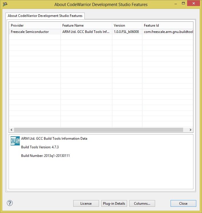

I saw the thread, I moved to codewarrior10.6 from codewarrior 10.5 and tried this code there but the issue remained the same. Also I added
(volatile unsigned char)SPI0_S;
(volatile unsigned char)SPI0_D;
and I checked with both SS as GPIO and SS as SPI_SS once at a time.
