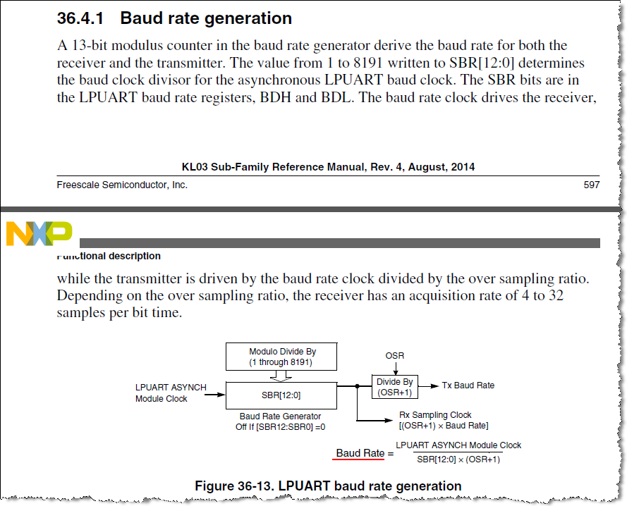

Don't know the 'LPUART ASYNCH Module Clock' that you selected, so I am not sure if the baudrate is well configured. But you can check the baudrate through send 0x55 and observe it by oscilloscope.
If you select 48MHz IRC48M. To achieve a baud rate of 300, you need set SBR=0x1388 and OSR=0x1F.

Sorry, I am not quite seeing where the 5000 is coming from and how that gives a 300 baud rate. With the numbers I am using I am finding that my baud rate is IRC48M/(SBR*(OSR+1))=48Meg/(4848*(32+1))=300.03 baud. Is there an aspect that I am not understanding?

RC48M/(SBR*(OSR+1))=48Meg/(4848*(31+1))=309.41
RC48M/(SBR*(OSR+1))=48Meg/(5000*(31+1))=300.00
You were using the wrong value for OSR - is is the value in the register (0x1f = 31).
Mark
5,155 Views
beaurogers
Oh I see now, that makes sense. The manual describes setting the OSR register to 11111 as being 32, so that is where my confusion was. I was wondering why there was a +1 in the baud calculation. Thanks a lot Mark and Robin.
