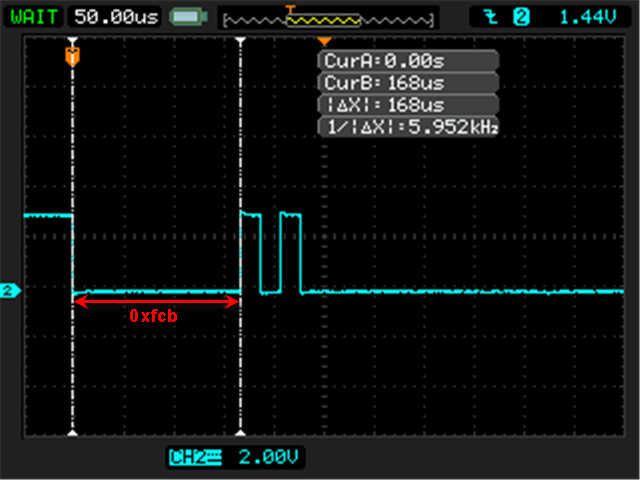

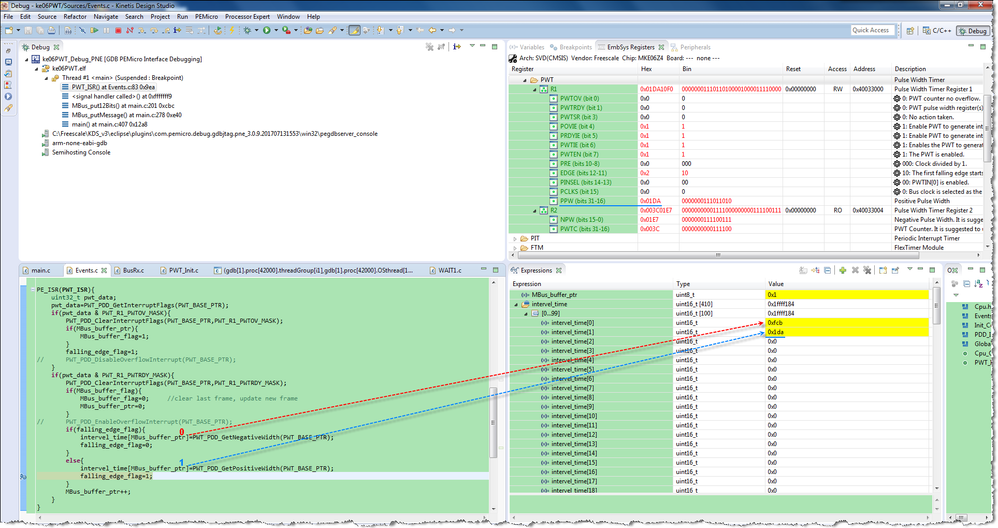

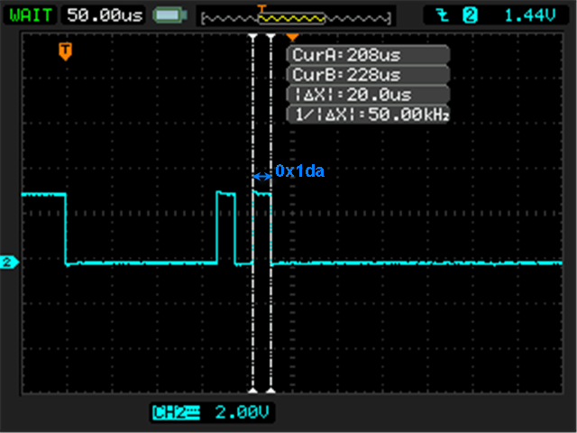

Test with the FRDM-KE06Z REV A1 board. Press the SW2 and wait the code stop at the breakpoiont.
Not sure if these results meet your needs.
But the PWT seems works and catched first Positive pulse and second Negative pulse.
intervel_time[0] catch the NegativeWidth, and it meet the data: 0xfcb/24MHz=168.46us
intervel_time[1] catch the PositiveWidth, and it meet the data: 0x1da/24MHz=19.75us
Robin
