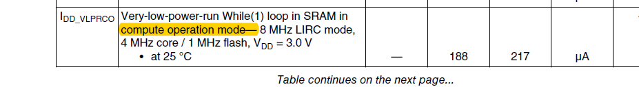

I have a very basic code for the KL03Z for which I'm trying to verify the current draw in VLPR mode as noted in the data sheet. I have the QFN package of the microcontroller, I have set the LIRC clock to 8MHz and divided it down so that the core is at 4MHz and the bus is at 1MHz. The datasheet shows that the current draw should be either 188uA or 209uA depending on the meaning of "compute operating mode".
When I run the attached code, I get 1.06mA. When I step through the code using the debugger, I see the correct current (~184uA). I'm using the latest KDS software and Jlink. When I disconnect the Jlink, I still see the 1.06mA. The PMSTAT register shows that I'm in VLPR mode.

1. Why do I not read the correct current draw when I run as opposed to step?
2. What is the "Computer Operation Mode"?
3. How do I put the While(1) look in SRAM vs flash as noted in that same datasheet entry? Is what I have in the code SRAM?

The third question also comes from me trying to understand the specification on the datasheet. The VLPR currents are specified as sometimes being in SRAM and sometimes in flash. How do I know which one I have set-up in the code I sent you? I'm assuming SRAM, but I didn't specify either. One of them must be the default.

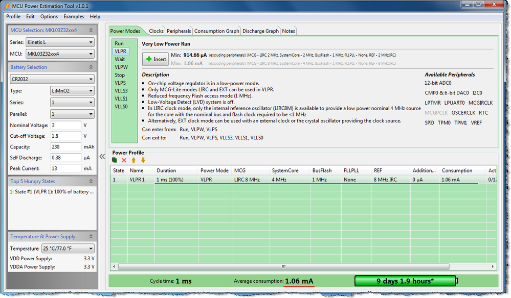

I got the higher current just like you:

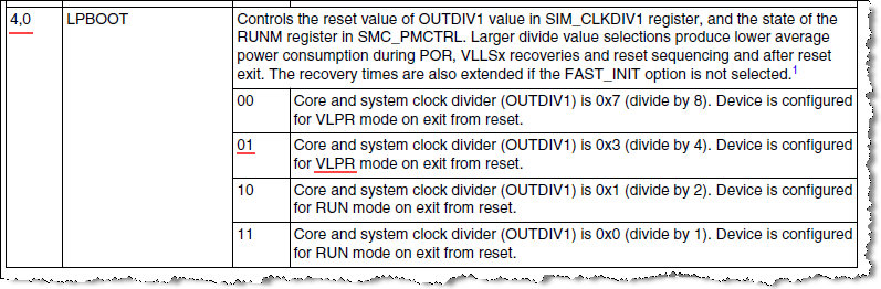

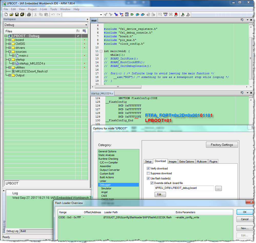

1. I have test the power_manager and power_mode_switch demo in SDK_2.2_FRDM-KL03Z, after input 'D' the MCU enter VLPR mode. But I get the higher current about 1mA.
2. I have also try to configure the FTFA_FOPT[LPBOOT]=01 or 00(ensure the MCU direct boot to VLPR mode), still get 1mA current. (I have attach the test project. You can test it with IAR and FRDM-KL03Z board.)
3. The Power Estimation Tool for Kinetis MCUs also show me that the VLPR mode current is about 1.06mA.
I have report this to AE team and will inform you ASAP when I get the reply.

feedback:
The VLPR mode data sheet notes indicate the code, the while(1), is being run out of SRAM. Most likely the flash has been turned off as well, but I can't be certain.  If you run the while(1) out of flash you will bearing the flash operation power which you have shown to be about 1 ma.  Check this out and let us know how you come along with your spec checking.
You can use the low power modes VLPW, VLPS, LLS and VLLSx as well if you are not running your function in VLPR 100% of the time, transitioning out of low power mode with interrupts and from LLS and VLLSx with the LLWU module inputs. I wrote the app note AN4503 , it has a wealth of information available about Kinetis Low power modes.
