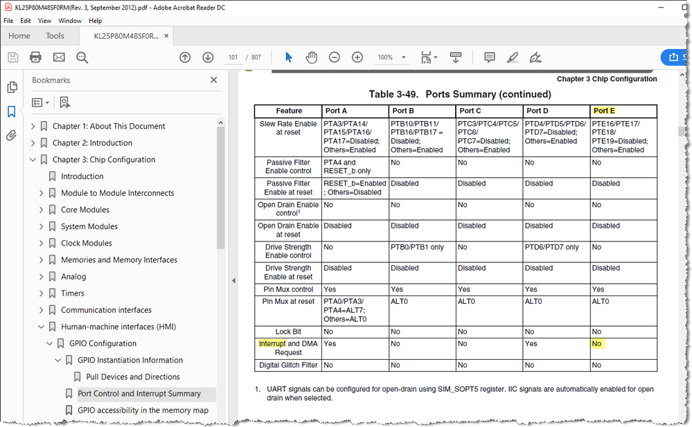

Hi all,
For reasons, I need to be able to use a button to do an interrupt on PORTE for the KL25z board. I got my code to work for interrupt on a different port (PORTD) but I can't get it to work on PORTE. I know I have to modify values in startup mkl25z4.c and MKL25Z4.h to enable it. I tried replacing all PORTD_IRQn and PORTD_IRQHandler with PORTE_IRQN and PORTE_IRQHandler but so far I have no luck. Please help me to enable this interrupt.
Thanks in advance,
Huy

Hi Huy,
I am sorry to tell you that the Port E doesn't support interrupt.
Robin
