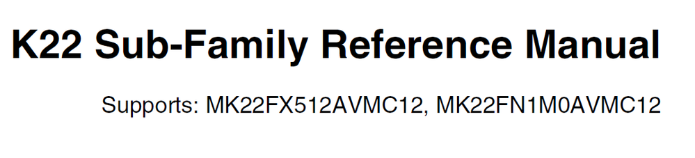

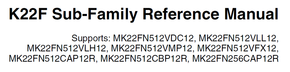

There are 12 different user's manuals for K22 parts - you need to use the one that matches your exact part. If you have a part with HSRUN mode but you don't have it in the document it can only mean the document is not for your exact part.
Look at the very first page of the user's manual to see the parts that it can be used with - for example here is the first page of the K22P121M120SF7RM which is one that does have HSRUN mode:
compared to one that doesn't (K22P121SF5V2RM):
The K22s can be somewhat confusing since different K22 parts can be quite different and incompatible, matching more closely to other differently names parts types.

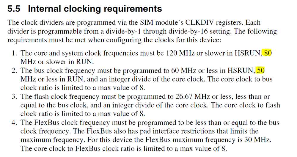

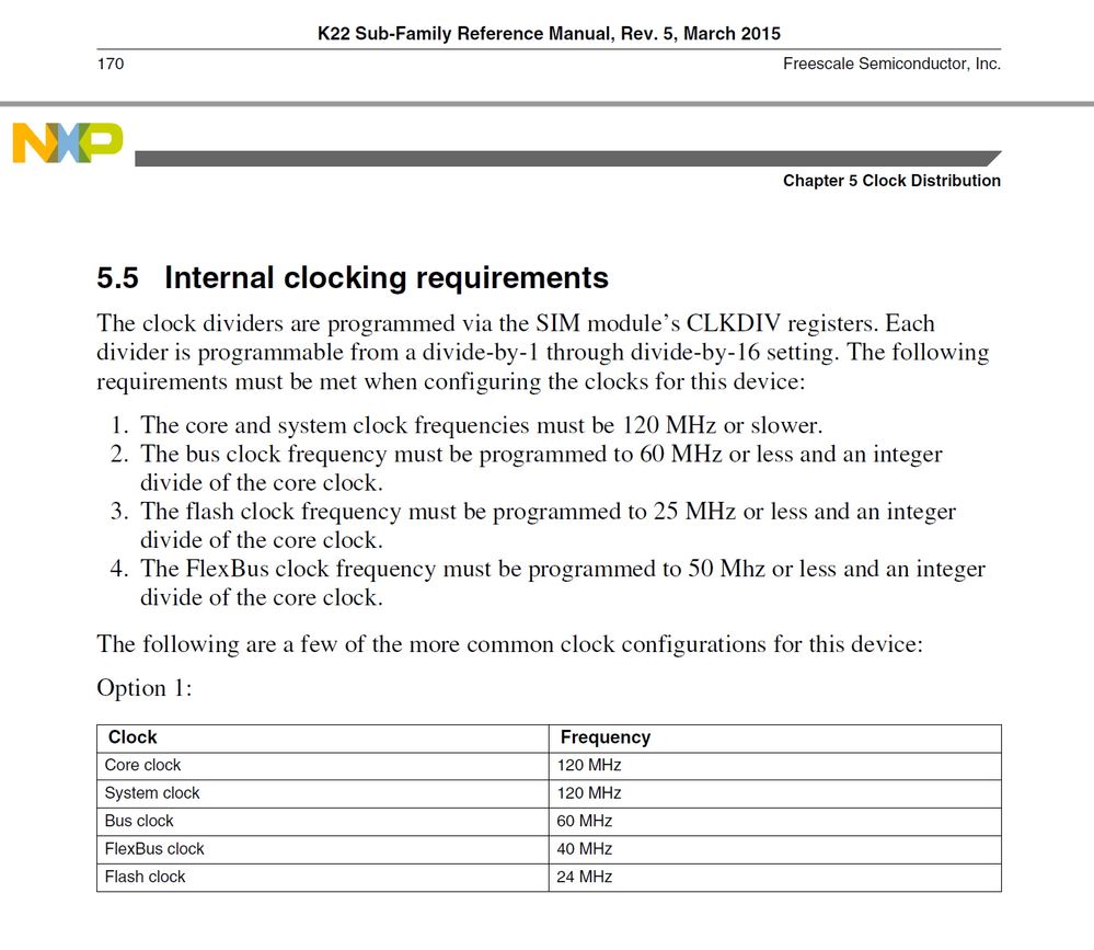

Can I ask what document you're referencing above?  I can't find a "users manual" for the K22 devices - my primary source of information is the datasheet and reference manual for a part.  Should I be looking somewhere else?
I'm asking because when I look for "Internal Clocking Requirements" in the RM for the MK22 I get:
The MK22 documentation that I have (which is the latest available on the website) doesn't reference the "HS Mode" at all.  I'm going by what I'm reading here and what's on MCUXpresso.
Is the simplest solution to call "BOARD_BootClockRUN", which puts the processor into RUN Mode before the write takes place and then call "BOARD_BootClockHSRUN" when the Flash write is complete?  I know that I have the other clocked peripherals to deal with, but I would like to experiment with this now.
Comments?

mjbcswitzerland
Specialist V
Myke
Since I don't use the SDK (I use the uTasker project as optimised solution) I can't say which routines to use for the SDK but I can show these:
1. The HSRUN mode prevails over warm resets so in order to ensure RUN mode when HSRUN is not wanted after a reset I use this:
    if (SMC_PMSTAT == SMC_PMSTAT_HSRUN) {                                // if in high speed run mode we switch back to run mode
        SMC_PMCTRL = (SMC_PMCTRL_STOPM_NORMAL | SMC_PMCTRL_RUNM_NORMAL);
2. When HSRUN is used the following is set before moving to the higher speed clock settings:
    SMC_PMCTRL = SMC_PMCTRL_RUNM_HSRUN;                                  // set high speed run mode (restrictions apply) so that the clock speeds can be obtained
Therefore, essentially to switch back to RUN mode you need to first reduce speeds to within RUN mode specs then do an equivalent to 1.
To step back up you need to do the equivalent of 2. and then set the clocks back to the higher settings again.

myke_predko
Senior Contributor III
Hi Mark,
Okay, I have the demo FRDM-K22F (with the MK22FN512VLH12) operating in RUN Mode at 60 MHz with the USB and flash write working.  It's interesting to see how much slower the SPI operations are at 60 MHz.
I spent a few minutes with the clock tool and came up with my own 120 MHz clock configuration with USB interface and the product seems to be running fine.
Thanx for your help and patience with me.
myke
