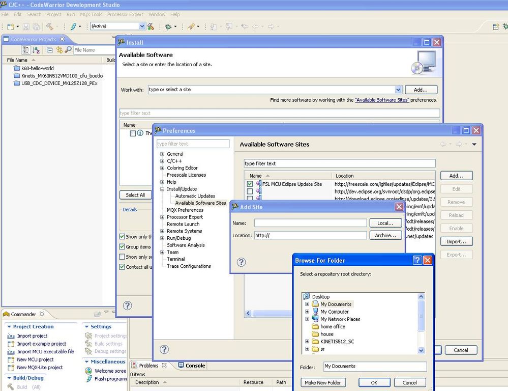

Would you please try to click Help->Install New Software, and select the zip file according to the following steps?
Hope that helps,
Hope that helps,
