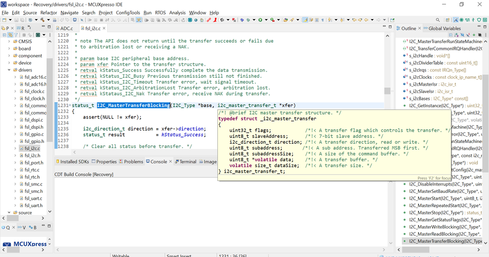

yoursanil3
Hi @bobpaddock
If we consider the function that which i am calling it initially takes the 7 bit address and after that R/W bit. please find the attached.. Anyways i  have tried with the address that you have suggested still facing the issue.

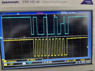

yoursanil3
Hi XuZhang,
I am using an external ADC ie., ADC 7924, i have tried to capture the data through oscilloscope and observed that slave address is not acknowledged to the master i have cross verified with the slave datasheet and our hardware board and can confirm the slave address is same i also checked with voltage levels that were given to slave and they were also fine.
please find the attached, slave address is 0x49 and after that write bit then slave has to acknowledge to that by keeping the SDA low but the line is going high.
Thank you,
regards,

Joey_z
hi,yoursanil3
If a device is not present on the bus, and the master attempts to address it, it receives a not-acknowledge because no device is present at that address to pull the line low.
I saw in some off-chip ADC module documents that if you want to set the address of this module, you should pull a certain pin low or high in the hardware settings. Please confirm whether you have done so.
You can also send me the instruction manual of the ADC module you use so that I can learn more information and help you.

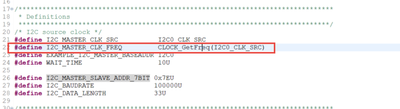

15,589件の閲覧回数
Joey_z
hi,yoursanil3
You can check in the I2C_MasterStart function whether the address has been shifted in the program.
Here are some suggestions for you to check.
1. Make sure the hardware connection is correct, there is no cold soldering, and whether the power supply voltage may be insufficient or unstable.
2. Confirm whether the I2C communication rate matches the rate supported by the slave.
XuZhang_1-1721301237934.pngXuZhang_1-1721301237934.pngXuZhang_2-1721301249943.pngXuZhang_2-1721301249943.png
