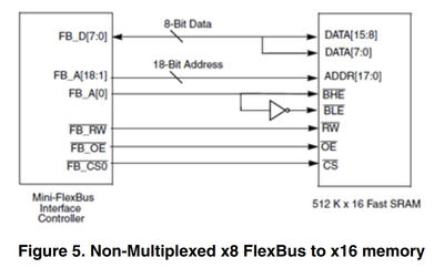

There are some similar posts I have noticed that utilize this or similar parts but they have experienced some difficulties in doing this and getting reliable operation. Looking at the application note Using FlexBus Interface for Kinetis Microcontrollers it appears that the flexbus address lines FBA1 - A19 should be connected to the RAM A0 - A18 and that Flexbus FBA0 should drive the Upper Byte and Lower Byte control inputs to the SRAM - see diagram below.
Is this correct....? - or are the existing posts on this subject which seem to connect the flexbus FBA0-18 to SRAM A0-18 with the Upper Byte and Lower Byte selects driven by the byte enable outputs from the MCU correct. This is the way the project is currently configured, please see extract from project pin routing below..?
This is how the connections are currently configured but we are hesitant to progress to completing the pcb board layout as any changes to the above will have a big impact on the board layout.

I suppose that you referred to AN4393.pdf, obviously the hardware connection in the AN4393.pdf is correct, but the hardware connection can only access SRAM in BYTE(8 bits data bus) mode instead of half-word(16 bits data bus) mode although the external SRAM supports half-word access.
Of course, the FlexBUS of K60 supports half-word(16 bits data bus) access.

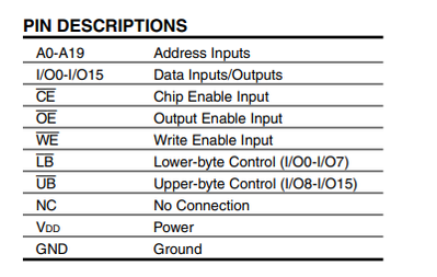

This is the signals of SRAM IS61WV102416BLL
You can connect as following:
FB_A1~FB_A20 of FlexBus are connected to A0~A19
FB_D0~FB_D15 of FlexBus are connected to I/O0~I/O15
FB_BE_7_0 of FlexBus is connected to /LB
FB_BE_15_8 of FlexBus is connected to /UB
FB_OE of FlexBus is connected to /OE
FB_RW of FlexBus is connected to /WE
one of FB_CS[x] is connected to /CS
