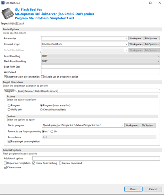

I'm using microcontroller MKL02Z32CAF4 installed on a custom PCB and i program it with MCUExpresso IDE version 11.5; I use MCU-Link debug probe with v 3.133 firmware; my SKD is SDK_2.x_FRDM-KL02Z, but I also used SDK_2.x_MKL02Z32xxx4 and the result is the same.
When I flash the MCU (using SWD) with entering the debug mode, I can step through the code, continue the execution and I see with an oscilloscope a pin on a PCB toggling in an infinite loop (that is all the code is doing).
However, when I flash using GUI Flash Tool (or I just power of and then on after debugging session), then nothing happens - it seems like the code isn't running.
I've read a few posts in this forum and didn't find an answer that worked.
Here are a bit more details: I do mass erase, and do SOFT reset handling, and a reset on connection and on completion.
Please help - is there any settings I can check? Does the IDE do something magical in the debug mode that makes the code run, but just flashing it won't work.

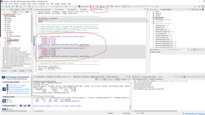

Pls try to set the flash configuration field with:
__attribute__ ((used,section(".FlashConfig"))) const struct {
unsigned int word1;
unsigned int word2;
unsigned int word3;
unsigned int word4;
} Flash_Config = {0xFFFFFFFF, 0xFFFFFFFF, 0xFFFFFFFF, 0xFFFFFBFE};
The FTFA_FOPT[NMI_DIS] bit will be cleared
Hope it can help you

xiangjun_rong
unsigned int word1;
unsigned int word2;
unsigned int word3;
unsigned int word4;
XiangJun Rong
7,841 Views
il_andil
@xiangjun_rong this did the trick. Thanks a lot!
