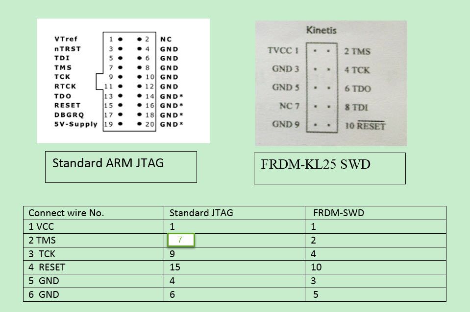

omerbulut
ok. I tried to program mkl26z128vft4 with segger j-link edu. but it didn't realize it. I tried again and again, it didn't work. Could you suggest me any idea about it?
4,130 Views
kerryzhou
     SWD_DIO  pin need to add external 4.7K to 10K pullup resistor.
    NMI_b pin need to add external 4.7K to 10K pullup resistor.
  After you add it, use the Jlink command to check, whether it can find the ARM cortex M0+ core.
  Any question after testing, just let me know!
Jingjing
4,130 Views
omerbulut
Hi;
I add SWD_IO pin an external 4.7 k pull up resistor. It doesn't work. Could you help me about it please?
Thank you very much
4,130 Views

omerbulut
could you say to me the pin out connections for jlink segger to mcu?
Thank you very much..

kerryzhou
Please refer to SWD interface picture I already give your in the above reply.
The JLINK is using the standard interface, you just need to connect the correct pin out.
Please refer to that picture I already give you.
Jingjing

omerbulut
I have a question exactly :smileyhappy: Which pins enough for the programming? Example I chose the Segger JLINK company. or P&E Multilink. Which pins do I need for this programmer and how can I do? Could you please lead me about that? I will appreciate about it. Thank you very much :smileyhappy:
4,130 Views
kerryzhou
Hi &Ouml,
      About the pin for programming, you need to use the SWD interface:
    VDD, SWD_CLK(PTA0), SWD_DIO(PTA3), RESET_b(PTA20), GND.
   Here SWD_DIO need to add 10K pull up, RESET_b need to add 4.7k to 10k pullup resistor and connect 0.1uf capacitor to ground.
  The above is the KL26 SWD interface design, and the MCU pin used for programming.
   About the JLINK programming, because JLINK is using the standard ARM JTAG.
   Please follow this picture:
TMS is the SWD_DIO pin, TCK is the SWD_CLK pin.
Besides, you can't program over usb via computer without a programmer, you must use the programmer to program the KL26 chip, FRDM-KL26 seems use the usb port to program the chip, because it have the onboard programmer.
Wish it helps you!
