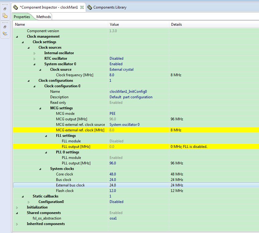

I have a MKL26Z128VFT Freescale Microcontroller. I want to use additional crystal capacitor for USB communication, I mean it needs 48 MHz. I cannot create and add its library with the Processor Expert. Could you suggest me way that can works for it? thank you very much..

      Could you tell me what the external crystal you are using? 8MHZ?
      If yes, you can configure the PE like the following picture, and choose your USB clock source to the MCGPLLCLK, then the USB clock will be 48Mhz.
Wish it helps you!
