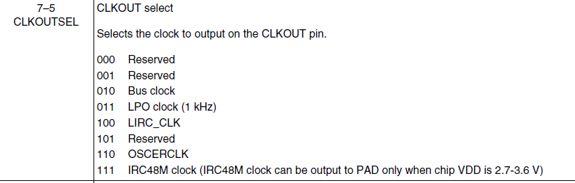

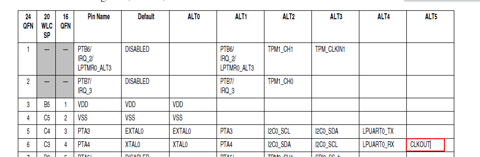

I have a Kinetis KL03Z board. I try to output the 48MHz system clock on a GPIO pin for some other use, but have a hard time finding related information of doing this. Please advise. Thanks.

- then configure the PTA4 pin to CLKOUT through the register of  PORTx_PCRn -> MUX ;
- then configure the CLKOUT pin output BUS clock through
the register of "SIM_SOPT2" -> CLKOUTSEL to  " 010 "
