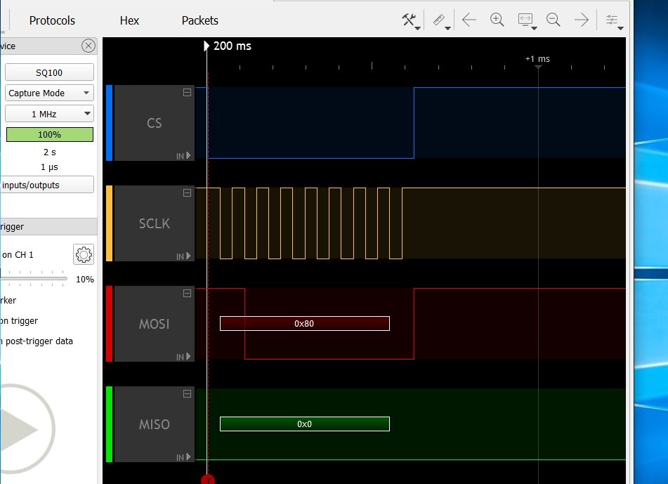

I tried to read an ADXL345 accelerometer, I have written my own SPI read and write because it doesn't work with processor expert.
The initialization of SPI is:
  SIM_SCGC5 |= SIM_SCGC5_PORTD_MASK;  //Turn on clock to D module
  SIM_SCGC4 |= SIM_SCGC4_SPI0_MASK;   //Enable SPI0 clock
  PORTD_PCR0 = PORT_PCR_MUX(0x2);//Set PTD0 to mux 2 [SPI0_PCS0]
  PORTD_PCR1 = PORT_PCR_MUX(0x2);//Set PTD1 to mux 2 [SPI0_SCK]
  PORTD_PCR2 = PORT_PCR_MUX(0x2);//Set PTD2 to mux 2 [SPI0_MOSI]
  PORTD_PCR3 = PORT_PCR_MUX(0x2);//Set PTD3 to mux 2 [SPIO_MISO]
  SPI0_C1 = SPI_C1_MSTR_MASK | SPI_C1_SSOE_MASK | SPI_C1_CPHA_MASK | SPI_C1_CPOL_MASK;   //Set SPI0 to Master & SS pin to auto SS
  SPI0_C2 = SPI_C2_MODFEN_MASK;   //Master SS pin acts as slave select output
  SPI0_BR = (SPI_BR_SPPR(0x02) | SPI_BR_SPR(0x08)); //Set baud rate prescale divisor to 3 & set baud rate divisor to 64 for baud rate of 15625 hz
  SPI0_C1 |= SPI_C1_SPE_MASK;//Enable SPI0
  WAIT1_Waitms(500);
the read function is quite simple, I write the adress and next read the answer;
uint8_t retour=0,dummy;
bool fini=FALSE;
  while(!(SPI_S_SPTEF_MASK & SPI0_S))
      //While buffer is not empty do nothing
    SPI0_D =adresse+0x80;//write adress+0x80 (read mode)
    while(!(SPI_S_SPRF_MASK & SPI0_S))
      //While received buffer is not full do nothing
    retour=SPI0_D;
    return retour;
For the test I init the SPI and try to read adress 0x00.
As you can see on the analyzer image, the byte is written, but nothing is read, the KL25Z do nothing. I should have a second set of 8 clock pulses.
Michel

In order to send an address and then read a further byte you must send two bytes:
- the address
- a 'dummy' one (eg. 0xff) - this will generate the second 8 clocks
- they you will receive the result value back
Mark

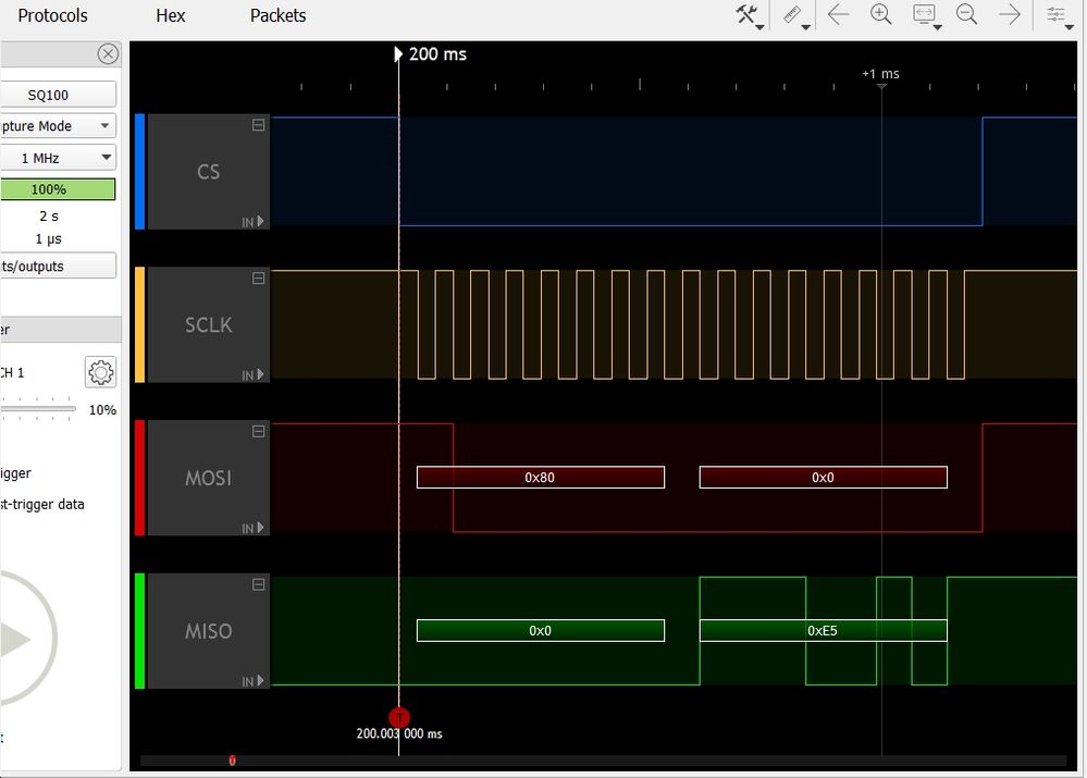

Thank you Mark, you have solved a part of my problem.
Now the picture of analyzer seems to be correct, but the SPRF bit seems to be unused. I have add a 5ms wait before to read the answer, I should received 0xe5 but I allways get 0!!.
My read function looks like that:
    bool fini=FALSE;
    SPI0_D =0x00;//write 0x0 to generate 8 clock pulses
    WAIT1_Waitms(5);
    retour=SPI0_D;
    return retour;
And the analyzer:
I think I am that with your help, I am very closed from the solution.
Michel

Hi Michel Meunier,
   Actually, to KL25Z, you don't need to delay after the SPRF is set, you can read the D register directly, and try again.
  If you still not OK, please add the dummy read:
    bool fini=FALSE;
    dummy = SPI0_S;
    retour=SPI0_D;
    return retour;
Wish it helps you!
If you still have question, please let me know!
Jingjing

After you configure the SPI interface add
(void)SPI0_S;
(void)SPI0_D;
This will ensure that the status flags start to work correctly.
Mark
